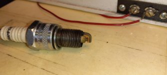

So after it cooled down a bit I pulled a plug (same #1) Me thinks it looks a ton better? What say you guys!View attachment 28630View attachment 28631
I don't think I've ever owned a Mopar that had plugs that clean.

Fired up ok, Idled it for 20mins. or so then pulled the plug, still looked about the same. 20250404_130112.jpg20250404_130124.jpgChecked the oil, she's still full & no smell of gas in it.

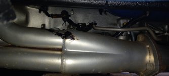

then I noticed my neutral safety harness was laying on the header, forgot to restrap it last go round, luckily I had sleeved it, just melted the outer plastic, black taped over that area & strapped it up well away from the headers! 20250404_123049.jpgThen I started to charge up the A/C to look for the leak, pulled a vac for about an hour & put in about a can & a half, bout 80lbsstanding pressure.

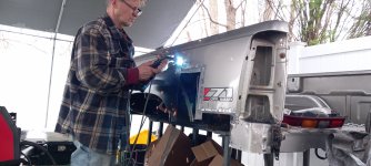

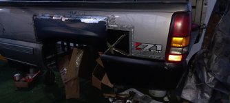

So Mark was out back working so I just watched him work & BS'ed a while
Inner well going on. 20250404_134049.jpgSpotting in the patch panel20250404_155505.jpg20250404_155523.jpgIt was nice watching someone else kick & curse, did lend the occasional hand & calmed down a bit!

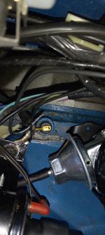

Here's mine, looks pretty stock?
Don't know what pressure it works at? View attachment 28642
Jamie @ dead dodge garage and Tom at rocket resto have found evidence that factory switches (you have a switch not a sender) are painted just like yours is, all the metal little or none of the plastic.
So it seems you likely have a factory switch so it should be the low pressure switch.
The other side of that evidence is that all factory sending units (for gauges not lights) have no paint on them at all.
If the switch has been replaced, 99 times out of 100 it hasn't been painted at all.
