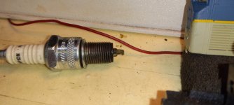

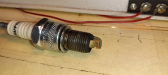

Pulled a plug before I took the test drive. 20250328_125839 - Copy.jpg20250328_125852.jpg20250328_122538.jpgtook the test drive, actually seemed to idle a little smoother, no big clouds of smoke, went on some main roads so I could at least do 45-50.
Kickdown worked again & got another nice chirp
Cooled it down a bit & piled the plug again, doesn't look terrible to me, I'd say the exhaust stinks a bit more, but no big black clouds, some gray puffs.

With an Eddy carb your idle fuel pressure should be no more than 6 psi at idle. The 2nd pic of the plug is a major improvemnt over the 1st. But still slightly darker than ideal. It seems that you are getting closer.
