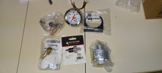

K, got off the pot & called summit, they will warrantee the regulator, so I'll give that one more try since it's easy to put back in, all set up for it.
before I mess with the fuel filter & making the return line work.
Also ordered the 20lb sender, the gauge/bracket/tee to put that in.

That will go in first.

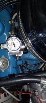

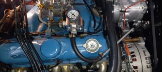

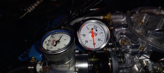

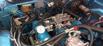

Almost all in, did the regulator first, started up with very low pressure, went almost all the way in on the adjustment & only reached 6, Set it on 5lbs at idle, shut it down to tackle the oil pressure junk.20250411_151928.jpg

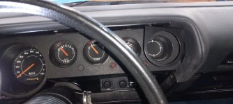

Hmmmm almost fits in my blank clock space!20250411_124803.jpgThis was a ton of fun, mighty tight space to work. 20250411_151943.jpg

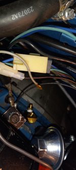

After much wailing & gnashing of teeth (miss ya Jass) I got the engine bay side done, fired it up again pressure on the gas already dropped, that's not making me feel any better.
Oil press 40 at idle, goes up about 5lbs when I rev it? 20250411_153454.jpgI think I have a spot under the dash to mount it if I can figure a good route in.

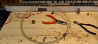

20250411_154253.jpgThat dang tubing does not want to uncurl!
So is 40 a good reading, up a tad from a 4lb sensor, now I'm wondering what my sensor was set for.
It was fun getting it out of the manifold, none of my sockets would catch that tiny squared off lip, finall found a metric that grabbed it enough to start it, that much fun for an 1/8" fitting is just NUTS!

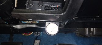

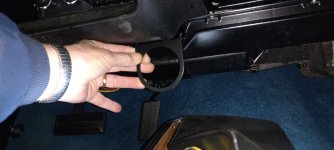

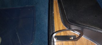

Really not finding a good spot for the gauge in the car, where I'd like it the best it won't clear the A/C duct. 20250412_121640.jpgConsole had a nice screw spot but won't clear there either20250412_122101.jpgBy the blank clock it will go if I cut down the right side a bit20250412_121835.jpgBut how do I hide the oil tubing, I do need to disconnect my seat belt warning light, that system is always on, belts buckled or not, already removed the buzzer, that was driving me nuts.
Maybe I can fish it through the hole with that removed (& even use the wires for the light?
It's that little circle on the side panel.
There's a spot in the bay that I could make work, but can't see that when I'm driving!!!
Clamped to the valve cover wire bar.
You might be able to make a bracket to relocate / place it where it will work for you.
I started the Duster, my fuel pump holds right at 6. What is it you need, 4.5?
The Carb book said not over 6 1/2, my pump delivers 7.
I still can't figure these regulators, it's supposed to have a range of 4 to9
I could not get to 7, this time I did see 6, set it at five, after 1 shut down & restart it dropped below 4.
See where it is on next startup, the one I pulled went all the way down to 1, how can you trust something like that?
See what this one does, if it messes up like that, it's 68's filter with bypass idea!

Found a good way in, A small piece of insulation near the gas pedal had 2 push pins, removed the upper & snaked it through there.
I problem solved.
Buy just tweaking the mounting bracket I got it to clear the A/C duct,
2nd problem solved.

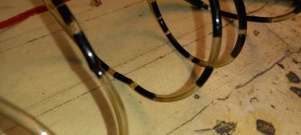

Thought I was cruising when the friggen line kinked in 2 places.
Luckily I saved some extra tubing that came with the other car, started from scratch AGAIN! 20250413_150959.jpg20250413_150206.jpg

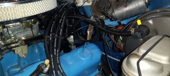

Started the car, regulator pressure was reading almost 4, so I was happy at least for the moment!
Goes even further into the abyss after that. had to raise the idle again to keep it running.

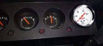

So I go for the test drive, now I'm reading just over 25lbs on the oil press, put it in gear & it drops to 20 & light flickers,
Drove around a bit & it got worse .
BOB!!!!! you jinxed me!!!!!!!!
Now even when I let off the gas for a stop it starts flickering, by the 3 or 4th stop it dropped to just about zero, I slapped it in neutral & the idle I raised is now way too high, but at least it brought the pressure back up, rest of the drive was put it in neutral for every stop & bang it into gear to get going.
Got it in the garage & wanted to check fuel pressure before I shut down, so neutral again & I go out & find this!!!!!!20250413_164112.jpgHolly crapoli, I'm going NUTS!
I guess this means I need a new oil pump?
Well, that showed the pressure switch is working as advertised.
