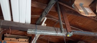

Reinforced my cross tie, will hang one door on that & use the engine hoist to hang the other door, those I'll have to wait for help to hang.20220719_144304.jpg
