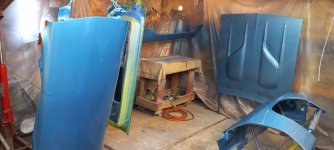

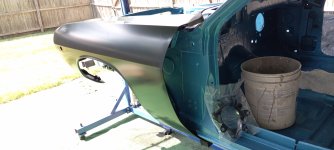

Paint shoot went pretty good, didn't see any garbage in the 3 coats of blue, but on one door as I was shooting a spider drops down from the rafters between me & the door, as I'm watching where it's going I messed up my timing on the gun & made a big nasty drip/run area, managed to wipe it off & correct most of it, but I missed a smaller one at the top of the mess, for now it's staying as is till I see how this whole job turned out.20220728_135516.jpg
Hood looks pretty good, this time I shot the clear a bit heavier, no drips or runs in that did pick up some dirt here & there, got 4 good coats on, if I burn thru now It's getting put together & taken to earl shibes!(sp?) 20220728_135206.jpg
fender has a couple of globs? on the side? otherwise looks pretty good. 20220728_135231.jpg

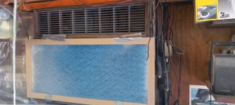

So I also added an extra filter to help it not to clog up my A/C coil, hope it helped? It started out white! 20220728_141032.jpg

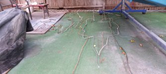

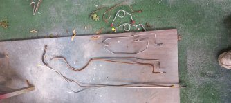

Starting to prep for the outdoor clear shoot on the shell, first I laid out the new brake & fuel line next to the old, gonna have some serious tweaking to do & some of the short lines have bigger fittings on them only found one of the old short lines & that has the small fittings, I guess i'll deal with them when I start rebuilding the brake system?20220729_131937.jpg20220729_132003.jpg

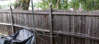

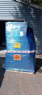

So just as we are heading home my son calls & says there's a delivery for me, the fender arrived, now they were supposed to call at least a day before, good thing he works from home now.
Packaging looked much better than the last parts I got.........20220804_150637.jpg

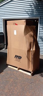

& then a box in a box ...............20220804_150915.jpgEven with all that there is a small dent in the side at the bottom of the headlight area............

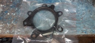

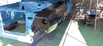

Actual bonus, head light mounting bracket, didn't even know that came with it? 20220804_153637.jpg
looks good hanging there, that's not a dent top front just the way the light hit it!20220804_151637.jpg
I ordered an AMD fender and it showed up packed just about like that. It seemed like part of their plan is to make it so bulky there's no way to stack anything on it in the truck.
The driver said he had another in the truck, not nearly packaged like that, I don't know how the quarter skins made it undamaged, 2 of them & some outer wheel wells & trunk drop offs in one box with a little packing paper between them???
