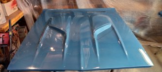

So with all that's going on with Mom I've been feeling pretty low. So when we got home yesterday I thought I would keep myself busy & try to finish sanding the hood, working the 2000 was going pretty well, most of the peel out & then I burnt through on a couple of edges, well that just pushed me into serious depression, not getting a break anywhere!
So I did some nasty touchups & packed it in for the day.
I've gotta come up with a new plan this paint job is killing me.

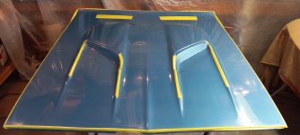

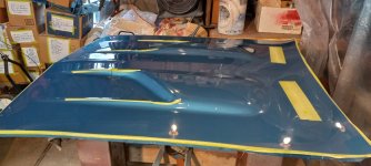

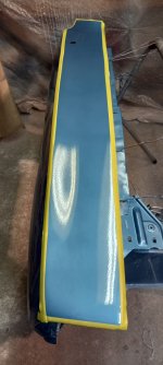

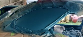

So new plan, see if I can buff out the hood without any more mishaps , so I taped off all the edges & the air inlets that get all messed up buffing.
started first round of compound on the left side...........
2 rounds on the whole hood, no mishaps yet!

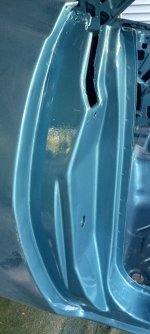

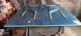

found 4 little black dots, 2 are in this pick 1 lower left I think the other is where the light hit it?

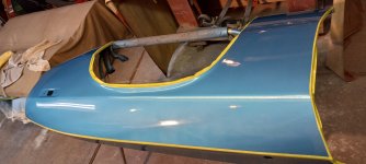

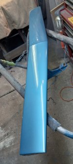

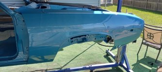

& a couple of spots with some peel it looks pretty deep to me I'm afraid to sand anymore, but this keeps me in the 5 footer class, that C pillar may make it a 10 footer!! 2 more rounds of buffing on that hood before I can declare victory.

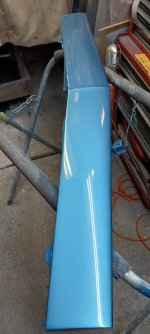

Tomorrow I'm going to try just buffing the fender with no sanding & see what that looks like?
