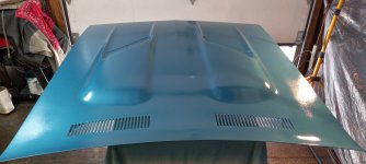

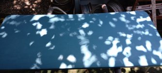

Couldn't wait, had to see where I'm at, hit a bunch of big areas with 600 to see what popped out at me, getting a little depressed, was hoping at least the trunk lid would be good to go, did get all the light dirt out, I'm up to 1000 grit, but about 6 or 7 little black dots popped up the deeper I got, this I may just buff out to see what those dots look like when it's done?

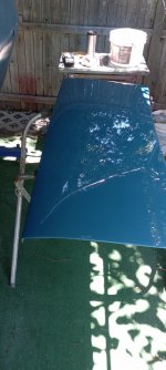

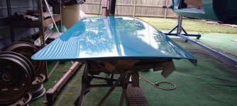

1000 grit after it dried, most of the peel is out.

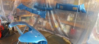

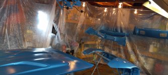

with it wet & my strong cheater glasses on I pick up those dots.

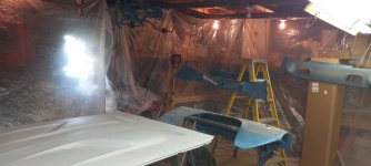

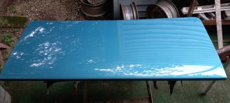

guess 5 footer is gonna be the results!

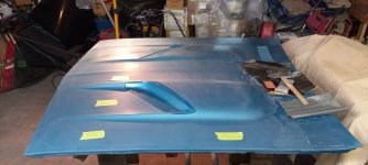

Drivers quarter looks pretty good, only 600 on this

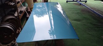

just left of center is the worst one that showed, should sand out, I hope!
