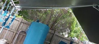

Got the doors on the vertical, hung one, but these babies are hefty, the bar is sagging quite a bit, hope I don't go out in the am & find it & the tent on the ground! 20220623_140231.jpg
the other I just stood on the hinges, the bottom will be a tough shoot but at least it doesn't have to far to fall! 20220623_140210.jpg

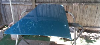

Honestly it's easier to just spray a coat of bse over the whole panel.
But, if you're willing to experiment, you'll need to either use a blending solvent for the base, or do it over a wet-bed.
A halo-effect is metallic stand-up, and gives the same look as if you've sprayed base over too-deep sanding marks, though the causes are different.
Blending solvent is really nothing more than a thinner designed to keep smaller particles in suspension better, allowing them to orientate themselves flatter so that halo effect isn't noticeable. It's only used on smaller spots like you've got here. It takes a bit of practice to get the hang of using it. Truthfully, I've used regular speed thinner (reducer, depending on what your paint brand calls it) with good results, but blending solvent takes some of the guess work out of it.
A wet-bed does essentially the same thing - keeps the particles in suspension until they settle it to their proper orietation, eliminating the look of fringe metallics standing up. It involves shooting a coat of heavily reduced mixed clear over the entire panel, and then laying down the spot repair with the base coat.
Clear thinning is roughly 100% after activation, and it's a one-coat only spray. Base is thinned as normal.
Regular clear is then used as per a normal topcoat, after proper flash times. There is no tacking after a wet-bed, though, unless you're extremely gentle with the tack rag.
Both methods require a bit of practice, but once you get the hang of it, nib repair is never a challenge.
B5 should work really well with either method, or you can just shoot another coat of base over the entire panel, and hope it's clean.
Golds and silvers are nightmares for spot-blending...

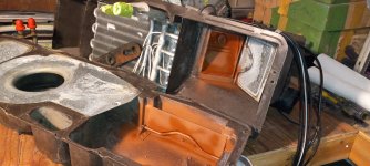

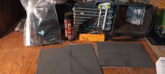

couple of days to catch up on, cleaned up the heater box a little more, got most of the rust off the two doors that had rusted & shot some primer on them. took a look at the foam kit & leafed through the instructions again, I think they were written in Mandalorian, I can't follow, hope all the pics I took help, actually had the adhesive & sealer in stock, so next really hot day maybe I'll kick on the A/C & start putting the foam on? 20220627_150451.jpg20220627_151042.jpg

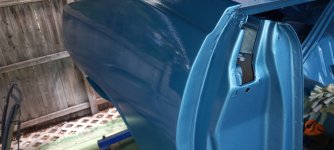

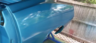

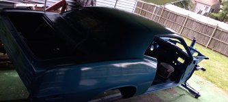

Today I actually set my alarm, got my laziness up at 7, trying to beat the heat & the bugs. The plan was to get the paint & clear on, well that I did, better results, but far from perfect, no bugs, still a lot of dirt devils , less than last time won't know how bad till I sand it all out for buffing? 20220628_131453.jpg

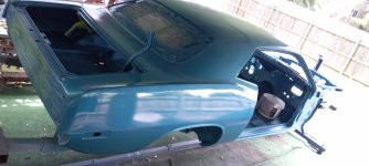

Quarters look pretty good, one deep dirt on this side...........20220628_131610.jpg
drivers side may actually be good to go, can't see anything , but I didn't put my glasses on either!!!20220628_131638.jpg

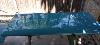

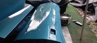

On the doors I had a new problem, a couple of the touch up spots alligatored on me, I was able to cover a couple with resto's wet on wet tips, but this one got lumpy on me? 20220628_131513.jpg& later I found one more small area that went to swamp!

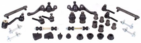

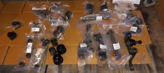

& finally the front end kit arrived, as I feared a lot made in Taiwan
Big stuff on the right
Stuff in the middle didn't say & the 2 bumpers on the left are from India
Hope they don't pop as I'm driving down the road in 10 years. 20220628_170129.jpg
