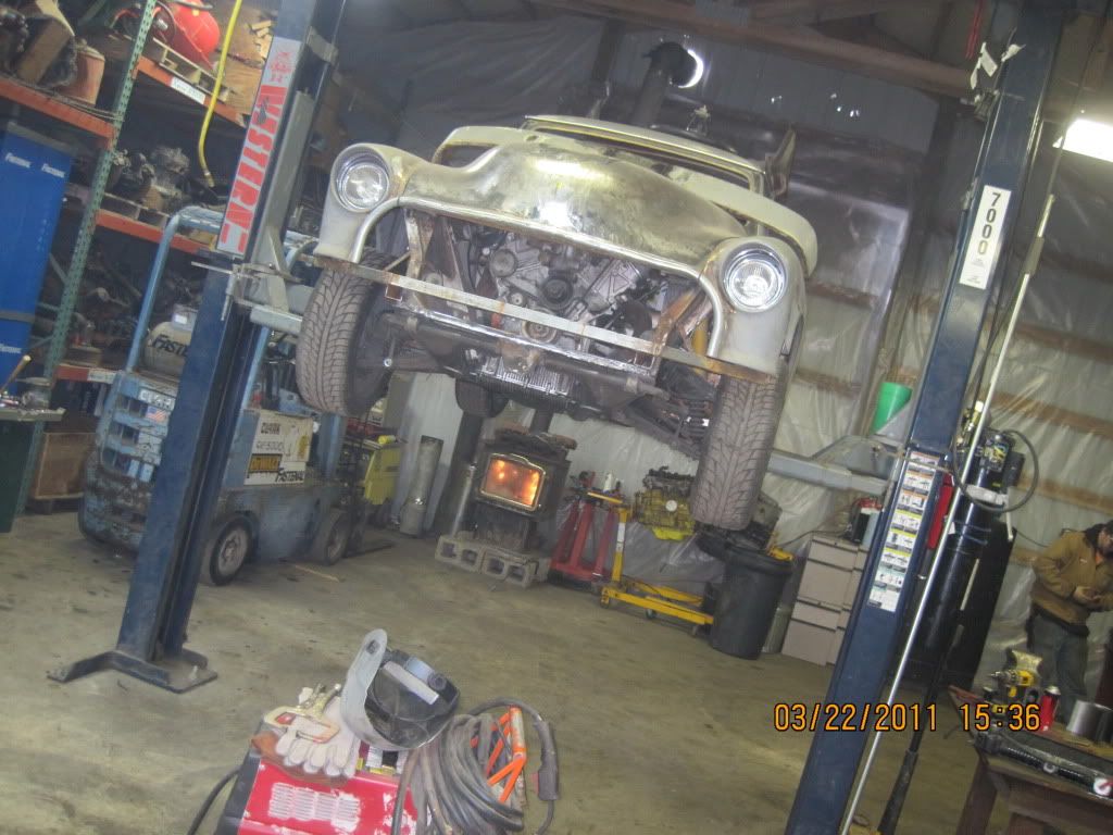

did some rear body bracing..someones bound to go..."umm your not making a cage with that stuff are you"..NO..im not...its simple to brace in the rear for if/when its pushed..and to keep the rear hatch area squared up...took me several hours and fighting to get that door opening squared up..everything from the middle of the side glass back was LITTERALY free floating back there so not only did i extend the frame into the body but added the hoop to help tie in the roof..the body is now ridged back there but also on the inside it will help give me a mounting point for interior panels..while doing this i started in on the batterybox/fuel tank brace work
