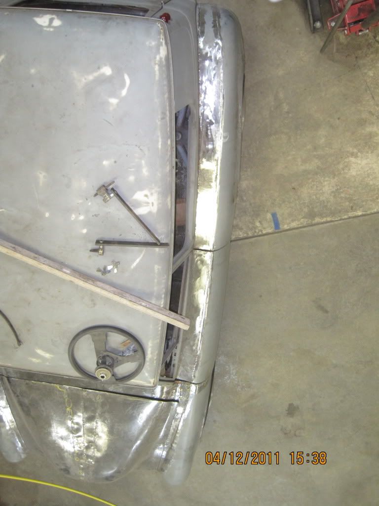

the steering got mocked up...spent a bit of time chopping off all the extra crap as i was trying to come up with a good column cover and a 4inch tube would have SERIOUSLY overpowered everything in the car..after chopping everything down that wasnt required now i can have a 2-2.5inch tube and simply have a flare out at the wheel....the mockup proved to me its in the right spot right to left but it needs to go up about 3 inches..maybe more...its had to tell exactly where it needs to bebut i know now that right to left its right where it needs to be..ive got no more room to move it tward the driver door at all unless it goes up a minimum of 6 inches or drops 3 to clear the brakes....so with the mockin places tacked in i got in and did a test fit..with the old milano wheel its sitting too low..mind you my wheel fits inside of that wheel but still its WAY to low...i figure the top of the wheel should be very neer on line with the top of the dash or bottom of the windshield frame....but atleast i know where to cut the dash...which i braced up while in there

first off this is my stock of "suitable" brake and gas pedal pads that i found....the ones my fingers are on..are saab brakes but im unsure of what the gas is from.....but thats the set i think i like best
i had some ideas on the steering column today but couldnt for the life of me find what i wanted for round tube...so i made my own LOL...alot of trimming testing trimming testing but the results speak for themselves
got the pedal arms hung for mockup as well
