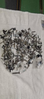

I had pulled out some screws I was pretty sure were interior for when the headliner & trim went in, then there's a bigger bag of just screws, most from the 2 cuda's but I'm sure a bunch that aren't but got tossed in the bag? 20240812_141030.jpg20240812_140737.jpg
Didn't pick out any door panel screws, I think the big one at the bottom is an armrest screw

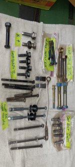

Big bolts, the engine mount ones I started to round so I bought new20240812_142610.jpgThe unmarked are not sure, the 2 big ones on top look like the leaf spring hanger ones, some of the long ones are probably alt/A/c /PS bracket bolts?
One of the orig leaf bolts needs a rethread

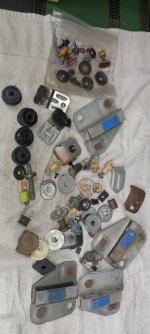

20240812_142619.jpg Some door glass parts, had just enough to fill out the ones I needed.20240812_143147.jpg

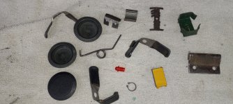

trunk goodies20240812_143421.jpgSeat adjuster springs, as you can see one went through the tumbler! 20240812_143552.jpg

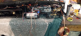

OK don't go crazy I found a pic of the turn signal flasher, other side of the dash & if I know me it's wire tied way way way up in the dash, hope it never goes bad.20230721_154527.jpg20230813_155438.jpg
Maybe I'll pull the flasher switch on & see if I have any power at the harness plug down there that I can get to.

In your second pic, the turn-signal flasher is almost exactly where the factory put it, except of course it was clipped to the side of the ashtray frame. Neither one of those pictures show the hazard-flasher connector, though. It's part of that huge harness that goes out of frame. That's the harness with the ignition and turn-signal switch connectors at the column.
