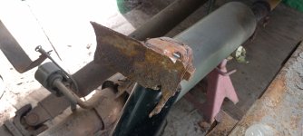

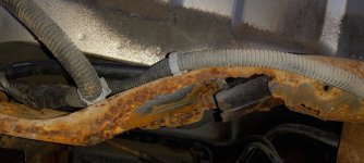

Today we got the bed off & started cutting out the front cross member for the rear shock!
Wasn't much left. 20240829_155422.jpgWhere the shock ripped itself loose! 20240829_155453 - Copy.jpgHis plan is to clean up the rest of the rails, weld in the new crossmember, por 15 the whole mess & then coat with undercoat!
With a bunch more cutting we finally got the new piece set in there...............20240830_143021.jpgDidn't think I would ever be sucking down rust dust anymore but here I am!20240830_143010.jpgGot that one spotted in...............20240830_180850.jpgThen we noticed the front one was gone too, at least that will be bolt in20240830_180901.jpg

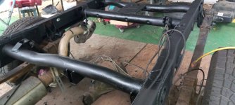

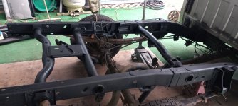

I wasn't around today, helping my son move. But mark was at it hard, got the welding
& cleaning done & por 15'd most of the frame20240831_170450.jpg20240831_170530.jpgAlso removed that last cross member that needed replacement20240831_170506.jpg
That's por 15, just slop it on, when I did the other car if you stay after it a while with the coats it laid out like glass, it took a long time to dry so you chased the drips & sags a lot.
When it worked it was great, when it didn't it was a royal pain, that's why second car is a rustolium base, how that will last I have no idea?
