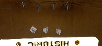

So my license plate retainers & screws came, now no where in the ad did it say 4, it showed one screw & one clip. I have all the other clips, wasn't gonna pay 7 bucks each for the screws I needed.
Well it came today & it's a set of 4.
This isn't the first incomplete ad I've delt with (fuel sender locking ring & gasket come to mind)
they are slightly different then the old clips, hoping the new screws go in the old clips, or I'll just do all 4 in the rear.
So I cleaned up my plates & noticed my buddy RUST marks on the rear plate, so I clear coated the new screws! 20240706_133419.jpg
