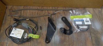

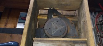

Well this was kind of useless, they sent instructions for an electric fuel pump! 20240620_140400.jpgCrate is done, now to find a nice heavy cardboard box to put it in! 20240620_163124.jpgManaged to get a couple of screws to wood on the compressor & a slot in the top board for the bracket, not sure my crate will survive a drop from waste high though? 20240620_164817.jpg
Dood, you doubled the weight of that thing! 😁
It's all worth it if it survives, really.

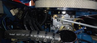

Not much on the car, the air cleaner had a breather stud on it so I dug out the breatjer I had with the fitting, that cleaned up pretty good, stuck that in.
Didn't want to just leave an open hole on the air cleaner so is this better? worse? or doesn't really do much? 20240625_145428.jpgThat in turn gave me a rubber not too hot spot to strap my plug wires & keep them off metal parts! 20240625_145448.jpg
Connecting the breather to the air cleaner is much better than leaving the hole in the air cleaner wide open. Since you've got stock valve covers, there should be a baffle beneath the hole to keep the air cleaner from sucking oil directly.
On the flip side, heater hose isn't designed to carry petroleum, vapors or otherwise. Keep an eye on it as it'll probably rot from the inside out. It won't be an immediate failure; I'm guessing you'll need to replace it on a yearly basis.
Only hose I had laying around big enough (actually 1 size too big at the cleaner) had to use a clamp there, see if I can find a dew feet of breather hose someday!
... and here I thought I was the master of zip ties🏆
It really does look like something I'd do and then regret later when I had to do something with that breather hose. :D
I also wondered if the bracket on the VC could have held some kind of a factory wire clip. I remembered there is one on the van but there is nothing mounted to it in any photos. I remember some kind of a vacuum booster mounted on that side, but otherwise it looks just like yours. So, no, not for a plug wire holder.
It's for a vacuum amplifier. That and the ported thermal vacuum switch controlled the EGR valve.
There's a spot on the side for the factory wire clips, I had 2 out of the 3 but with the headers & straight boots I couldn't figure out any good routing, I just ordered a big set from summit, I need a couple of duces where a couple of wires are close.

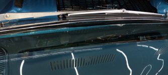

Blades came, now I paid way more than I should have to get the silver metal , everyone else had black, it called for 16", now I know back in the day wipers were pretty lousy, but it looks like 18" would cover a lot more of the window & I don't think even come near any trim?
That chrome plate was sticking up quite a bit & really twisted the rubber when parking, I got it down a little from this pic, I don't plan on driving in the rain, only if I get caught out.
So all 3 speeds worked, washers tried to spray, got about 5 or 6 inches out, hope more fluid & a couple of pump ups will get them working?
Is there a clip that goes on the lower rod, if so another vanishing piece! 20240626_142858.jpg
Trico used to make those blades in their Classic series, but they're NLA. 16" is the original size, but if you specifically wanted the correct blades (and I expect you did), they're probably not available in 17" or 18" sizes, since 16" was about as long as they got back in those days. I know 17" blades clear the perimeter mouldings but current frame styles aren't correct. In many cases, the newer designs are taller and will hit the hood, not allowing the wipers to park.
I'm sure you know this, but that lower moulding is bent. It should fit flat to the glass so the wipers ride onto it smoothly.
There's no clip for the E-body pantograph arm listed in the catalog that I'm able to find. However, there is one listed for the B-bodies in '74, part number 3431696. MegaParts sells a reproduction of that number on eBay that they claim is for both '71-'74 B- and '70-'74 E-bodies. I haven't got time to dig through all the catalogs (it's group number 23-67-80 if someone else wants to look), but neither the 1970/'71 book nor the 1974 catalog show it for E-bodies.
"I'm sure you know this, but that lower moulding is bent. It should fit flat to the glass so the wipers ride onto it smoothly."
I worked on that molding a little while & got it a little flatter, I agree it should be all the way down, somewhere else I was told that new glass isn't as thick as original & that may be the problem?
As stated above, I paid way too much to get the metal looking ones, how close to original they are I can't say I had that car 50 years ago!
Don't think I'll do the clip unless the darn thing pops off, I wish I didn't lose the extra carb clips Jerry gave me I think that would have done the job?
It's true that most current glass is thinner than the original. However, the trick there is to use a thicker butyl rope seal. The factory rope was 5/16", but 3/8" is commonly available--we stock it here at the store. It's easy enough to tell if the glass/rope thickness is the problem, because all of the windshield mouldings will have a noticeably wide gap to the glass, where on originals the moulding is nearly touching the windshield.
The wiper blades you have are about as close to OE as you're going to find. My point was that you're not going to find a 17" or 18" equivalent; wiper blades that long didn't exist back then.
A simple E-clip would retain the pantograph arm well. There's no side loading on that link. If it was going to disconnect, I would expect it to happen when the blade is travelling onto/off the lower moulding.
