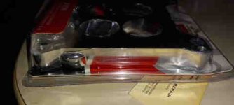

It is thick, I hope it doesn't raise it to overcome my switch from 3" h to 2" hi air filter, But I think it was ok when I had that thick gasket from Jerry on there? 1000002921.jpg
It's up really close, the wing nut still hit the insulation after I cut down the stud, but I don't think the air cleaner does, it did before with the 3" element.
If I pull it down & shoot some adhesive & glue it in the middle It would probably clear, but not sure I want glue in there?
My studs came up a tad short, got about 3/4 of the nut on before it bottomed out.
Not sure I like that plate being held down with Philips head screws?
Oh well it's in now, the other brand Jass noted did have allen key screws.
I used a pretty good size driver & got em in pretty good, well I think?

First and foremost, I'm glad you figured out the installation of the adapter from the first picture to the second!
I wouldn't worry too much about what drive style the screws are/were. I guess the advantage to Philips in this case is that it's hard to over-torque them? I would've expected socket-head (Allen) like Mr Gasket uses, but as long as they're tight you should be OK.
