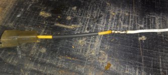

So lines are in, started on the wiring, they had taped the old cut line , so I had the right connector for the original A/C line, just had to extend that.
20240531_165609.jpgNo white shrink wrap, had to go black!

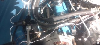

So 3 more connections to make & wiring is done, any chance of it working is the big question? 20240531_171321.jpgTomorrow I will see if it will run & move long enough to get in the garage?
Then the vac pump can run while I finish the wiring.

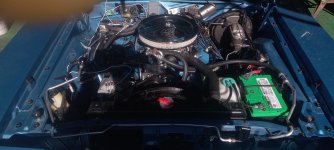

I'm giving up on this carb from jerry, this time I was trying to put it in the garage & actually got stuck in the street trying to turn it around, started pouring gas out near the bottom this time, got lucky & managed to run it long enough to get it in the garage.
So I am buying a new carb, I think I have a carter 600 cfm on there now.
Auto zone near me has an edelbrock #1906 AVS-2 650 cfm square flange for $447.

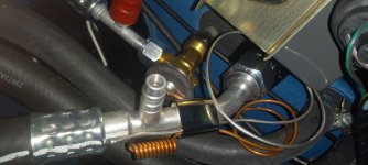

So the plan was to wash it & then pull it in, so being a tad pissed I took the hose & rinsed it off in the garage, I think the floor might be dry by now!20240601_150156.jpg
Messed with the clamp for the t-stat & the exp valve, but that seems off too, too big a gap for the 2 thin tubes & way small to get the rolled up exp valve end in.

I can change to a hose clamp, I'll give them a call to see what they suggest?
Is the circled thing what you're calling a clamp? If so, are you sure that's not heat shrink tubing?
The clamp they give is a snap on, a little shinier just after the offset, I slid both lines through it & they are loose, I do know good contact is necessary, that rolled up end on the expansion valve line is throwing me, never saw that before.
They did mention in instructions I could use a hose clamp, but need to know if I clamp the fat roll or just the thin tube.
Not a big deal, heck I could do both to be safe.
