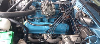

Ok today was light tinker around time, got the plug wires in, straight plugs at the distributor made it quite different, might need a few more Seperators?20240526_140158.jpg

So I went around & rerouted a couple of wires & cables, put a few wire ties, I guess this will never look tidy back there!20240526_151230.jpg

So after getting the loose hoses out of the way it was time to start it up & find I wasted a lot of effort.
new manifold gaskets & carb gaskets made NO difference, vacuum starts at 7ish works it's way to almost 10 after warmed up.
At least the new electric choke works.
Engine seemed a little rougher than before & it bounces around a bit on the new motor mounts, still have a ton of fine tuning to do!
Exhaust FAIL, Vacuum FAIL,
