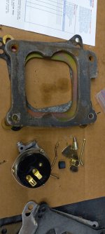

So Jerry cut off some piece that keeps secondary from opening till warm, say that was the problem???
Gave me a couple of those little clips I lost, a new choke assembly & what he says is the proper gasket for that manifold?
20240515_131857.jpg& through in an air cleaner for my troubles, was gonna paint & put on the 360 decal, but if it cleans up nice I may just leave it alone?20240515_131903.jpg

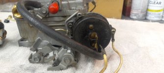

Trying to find something that wouldn't make me crazy I figured I'd put on the new electric choke, even that I messed up a bit.
Noticed no tubing connection on the new one, so like a dummy I proceeded to try & remove it from the old, looked like here were threads in the new ones hole?
Well when I finally broke it I called Jery, he says the new ones didn't use it, hope he's right on that or I have another place for a vacuum leak!

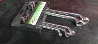

I had to remove the fuel pump that's the one that started to round over on me, drivers side I was ok, Mark had a nice offset box wrench that reached in between the parts where it bolts to the engine to hold the nuts, nothing I had could get to the lower nut.
It's nice having his stuff here He's got quite a tool box!

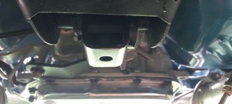

Well that wasn't easy, after a 5 1/2 hours which amounts to a marathon for this ole man the mounts are in, there are changes but not drastic enough to get the exhaust up much.
the mounts did show signs of possible tilt issues. 20240517_131108.jpg20240517_131658.jpgMark was over & helped the whole time, alone I'd be out there till midnight.

It did however level the motor, drivers side is now the same, before it was about 1/4" lower.
Then before we tightened everything I again tried to move the tail shaft over a tad, still seems to settle back to the same spot, not as drastic as before all this, but the rubber still sticks out one side almost 1/2"
Now I have no idea whether that is normal or not?

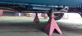

K before I start with the crazy stuff I took some pics of the exhaust as it sits with the car up in the air, 20240518_124640.jpg20240518_124649.jpgI got it up a little, hopefully whatever I got here & the inch I got the front end up that it will be livable?
She's still around 1" to 1 1/4 " low at the crossmember, TTI says 3/4" at that point! 20240518_124705.jpg

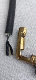

& of course I had to break something, one of the plug wires pulled out of the cap,
now I'm looking for conductor to crimp back in, seems to be none there, what is the conductor in these wires, do I just crimp around the outside rubber?? 20240518_155214.jpg20240518_155224.jpg
