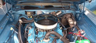

Didn't get much done, a surprise visit from the grandkids!.....20240519_132923.jpgso carb is on just have to check the torque specs & hook up the linkage, so I tested the air cleaner, she's up high, it pushes up into the hood pad, gotta see if I can get a thinner element!
Now I get to see if I can figure out those A/C brackets!

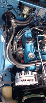

So I moved on to the A/C compressor install, even they had some of the hardware wrong, short 2 bolts of the size they specked in the instructions & others that were never asked for!
I got lucky & had the missing ones, now I have more extras? 20240520_162458.jpgSo I got it all mounted, putting in some of the hoses as I went, some look like impossible to get to now. 20240520_145615.jpgEverything is just snug at the moment, will find a belt before I tighten everything. 20240520_161900.jpg& after I lay out all the A/C lines I'll be able to cut the heater hoses to the proper length now that the bracket is in.20240520_161908.jpg

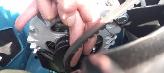

So they recommend a 54" belt, well mine are 54 & no where near long enough20240520_164452.jpg
not even sure ow many inches to add, any ideas on the lenght I should try?
K, ordered a set of moroso plug wires & a 2" high air filter element to try from summit, be here wed. I will hit autozone for a belt or 2 to test tomorrow.
That's a big help, I started out thinking the last two #'s were the size, then I measures my old around the outside & got 54, so it dawns on the dummy the middle #'s are the size, I have a cloth tape (well stealing from the wife) so I'm gonna try that around the pulleys, that should at least get me in the ballpark, then head to autozone & see what they have?

Measured around the pulleys, I come up with 56, with alternator as low as it will go, looks like about inch or two more of adjustment but the alt. bottoms out there.
Assuming there's no way I'm going to get a 56 on I'm thinking 2" bigger will clear it & not be too big to get it tight.

So the belts you have are 7480 and 7370. The first 7 is the width of the belt, the last three numbers are the length. 48” and 37”. If they are 4” too long go buy a 7440 and 7330. If the number is 7485 it is 48.5” long. There are a number of water pump pulley dia. A/C, non A/C etc.
wires & air filter are due in tomorrow, belt not till friday, I'm trying the 58?
So 3 roasty toasty days I have nothing to do, guess I needed a break anyway!
If I knew how many inches short I was I'd have something to go by, Pulleys came out at 56, so 2" short for my belt, but with the alternator bottomed out I did not think I'd ever get a 56 on, so I'm hoping 58 will clear but not by too much to be able to tighten it up.
Guess I find out this weekend if it shows up friday?
to get the right width & depth belt I just used the gates # they suggested & changed only the length, hope that worked?

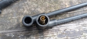

Holy crapoli, I can't even get plug wires right, they said 273 up to 360 MOPAR wires.
Maybe I'm wrong but I don't see any way these connectors are going to make contact at the distributor, & not even sure the plug ones went down far enough?
Old ones stick out a bit, new ones are way down in the top of the boot! 20240523_171858.jpg
