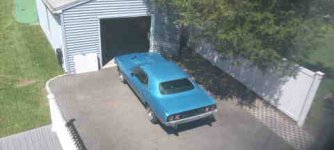

Muffler hangers came in today, with these I should be able to get about an inch and a half higher with the exhaust, then I guess I don't find out till I drive it if the whole car shakes, they will be mounted to the trans cross brace bolts???
At least I can move it around now & get it in the garage, nice to see it getting a little closer to the actual street!
from a second story window!
Now I can call the stripe guy & get my hocky stripe on.

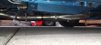

then I crawled under to check out the new hangers, these will get me a lot closer. 20240610_132659.jpg
Now I have to decide, 3rd hole (top) gets me about 1 inch higher, but second hole takes it all the way up, almost exactly the 3/4 TTI said it should be, but I think that will actually lift the back of the motor, not sure I want that riding on the exhaust?
right now the 2 low spots are 3 3/4 off the ground, header flange & upswing by the x pipe.
1st hole should end up around 5, second a tad better than 6?
What to do, what to do?

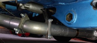

Well that was a bit of work for almost nothing, used the top hole I didn't want too much weight on the system, at the crossmember I gained maybe 3/4of an inch.
Still almost 2 down there TTI says 3/4"? 20240612_143929.jpgAt the header flange I got maybe over a tad over an inch, a smidge under 5, but the new clamp is the new low point at 4 3/4" 20240612_151414.jpgPass side pretty close to the same #'s 20240612_145803.jpgThis operation did not move the motor, I don't think I can get to the next hole on the passenger side, it was a stretch on that side, exhaust as high (started lifting the car) as I could get the pipes?
If I had to guess, I'd say the TTi instructions have some of the dimensions (like that ¾" clearance number) lifted from the non-header exhaust system instructions. I don't honestly see how it could go any higher with the pipes that are there. The headers have a natural downward tilt and the X-pipe is, in my opinion, wa-a-ay too far back. I don't think you made any mistake; I think that's how TTi designed it. I just don't see any way in hell to lift that exhaust any further without bumping a slight bend into each extension pipe between the collector flange and the X-pipe inlet. I'd say 10-15° between the collector flare and that first band-type clamp would do it.
The only TTi parts on my Valiant were the headers. I used a universal Summit Racing 3" X-pipe and modified it to fit. I have about 1" clearance at the torsion-bar crossmember with no extension pipes. The inlets of the X-pipe start curving upward at the first bend. Compare where your X-junction is in comparison to mine using the transmission crossmember as the reference (the E-body tailshaft housing is much longer, plus your transmission mount is on the front side of the crossmember). That was the only way I could get any kind of ground clearance at all, and I doubt I have 5".
