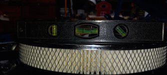

Believe it or not a guy on the train board reminded me about the carb being level, which 68 brought up the first time, I never rechecked after the new mounts went in.
So today I did, & it is still leaning rear a bit, couldn't get a good spot on the carb so I did it on the air cleaner.
Now with that in mind the tranny shims don't seem as much of a problem, I'll just be putting it back closer to where it should be???
So what say ye, shims or no shims???

Concerning the importance of a carb being level fore/aft, this is the first I've ever heard of it. I can't imagine why it would make a difference. If someone can explain it to me, I'd love to hear it. The second you leave a stop sign, even calmly, the fuel sloshes both to the rear (inertia against forward acceleration) and to the left (inertia against the engine's rotation to the right).
Your carb is level enough. "Correcting" this non-problem won't affect anything. It's tilting at windmills.

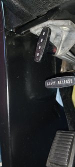

I thought you'd find this interesting. Lately removed from a '73 'Cuda and hot off the USPS truck:
I have another original cable around here somewhere that's got the angled mounting bracket like yours, as well as a couple of cut-offs--also supposedly original--that appear to side-mount (the mounting surface is parallel to the handle).
I'd be lying if I said I wasn't confused. Next time I'm over by the '71 I'm going to look at the lower edge of the dash and the kick panel area to see if I can figure out what the heck is happening with these cables.
I left mine cocked, to get it straight it was almost rubbing the brake handle.
Wow, I don' think the dash mount is straight, just less of an offset than my handle, will defiantly look at hat tomorrow
Don't see how any could be mounted to the kick panel that's kinda flimsy?
OK, definitely an angle in the dash, looks like there might be just enough straight to mount a straight one all the way left, looks like another hole far left too? 20240615_140228.jpgSide is all kick panel & would think screws had to go through that to te metal, didn't look for mounting holes. 20240615_140252.jpg
