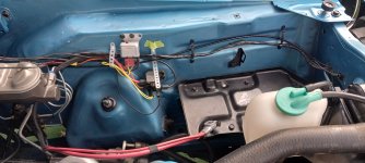

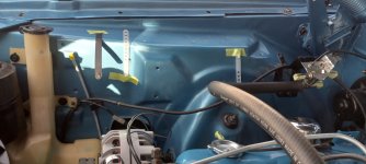

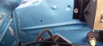

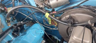

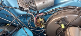

Put in the wire straps that I was sure of. 20240111_143124.jpgMoved to the 2 on the firewall that I had pics for, must have unplugged & rerouted more wires than are there! 20240111_143749.jpg20240111_145442.jpgJust laid in the ones I'm pretty sure of on the passenger side. 20240111_145449.jpg
& 1 more after the relay, looked like a good spot for one?
Need the battery in to see if the main wire will go under it? 20240111_145501.jpg

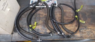

Back inside & cut a bunch of hoses & dug out the clamps, actually had enough of the right sizes for now anyway! 20240111_154924.jpg

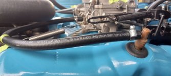

Looked thru my service manuel & could not find a pic of the heater hose from the valve to the box, I laid out the old hoses to where they seemed to fit & then put in the new ones, no matter what I do, a little longer, cut it 2 times & it just keeps kinking a little on me, don't know where to go from here, 20240112_145747.jpgDon't know if they are crisscrossed or not, but, going to the lower port with that might ease the tension?
Cut the vac lines same as the old, pcv to carb looks quite long, & not sure the old valve seated right in the valve cover, I think it's hitting the metal plate in there? 20240112_144455.jpgsame with the line to the booster, I think the fitting was in a different place on the other manifold, can I use the side port at the booster, much nicer run, It will loop around to the front one, but that doesn't look great? 20240112_144440.jpg
Finally there's one more hole that looks like it would fit the black round wire strap, only thing I can see that would go in it is the washer bottle water line?

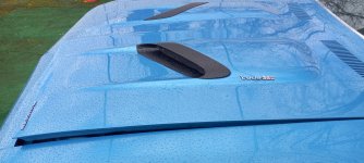

Messed with the drivers door a bit, got it a little higher, I have to double check the body lines, but this may be as close as it will get, looking at the upsweep in the fender they don't match. 20240113_133758.jpgAt least the water beads up nice! 20240113_124809.jpg

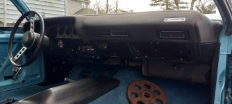

With that done (I hope) I put in the end dash trim & the kick panel. 20240113_124440.jpg20240113_124534.jpgLaid in the A/C duct, still not really engaging at the drivers vent, but if I could figure out a way to strap it up I could live with it? 20240113_133632.jpg

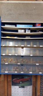

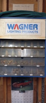

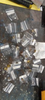

Back to digging around in the garage, found the leftover light bulbs from the other car................20240113_144941.jpgif that fails I have the wagner rack I got when my bro in law passed away, I miss you man.
20240113_144916.jpgmore lights & fuses at the top20240113_144908.jpgI suspect this ids from an old caprice, he had a ton of those, if anyone can use it & I can't speak up! 20240113_144956.jpg
On your heater hoses: It looks like if you take about another inch off the valve end of the upper, you'll straighten those kinks.
Don't forget the lower dash trim around the radio. It's essentially a mirror image of the one around the heater controls. I think you need to have that in place before you can install the AC-only trim panel, which until seeing your picture I never realized was so necessary. Man, that duct sticks out like a sore thumb. I still need to find that duct, which I'm sure you're aware is brutally expensive. At least I need two of 'em (both my main project and my '71 are AC cars and missing it). 😖

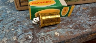

I'm not sure where you came up with a 550 flasher, but I can honestly say I've sold exactly one in 37 years, for a custom application. We had 'em in stock everywhere I've hawked parts, but it never moved. The only reasonably-common applications for it were 1962-only Ford T-bird/Lincoln Continental, Toyota Land Cruisers through '77, and some 1972 Dodge P-chassis trucks. Everything else is Euro. Lots of little sports cars, Jags, and some Benzes. In fairness, my buyer's guide only goes back to 1962, so some older Fords (and other makes) might've used it, but being 12-volt means it's mostly '56-up.
I'm down to my last piece of 3/4 hose, I'll check to see if it's longer or shorter before I cut that one, would like to have a backup if I go too short & not have to buy more at this stage of the game!
The 550 came from my bro on laws stuff, he had a carb rebuilding shop for a couple of years (could have used him now, he probably had an original carb in the basement) he took over the shop from a long time rebuilder, they junked hundreds of old carbs when he went bankrupt.
don't know why he took that one home?

Lower trim is a problem, I have one short thinner piece that broke off the one in the pic, but no screw holes in the bottom, was actually looking for it the other day & it now eludes me, I had it in my hands not more that a week ago, the even skinnier piece at the radio end was not there.
I think that was all one piece & also really hard to find & spensive!
