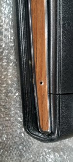

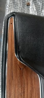

Filler went in good, bit tips went in smooth started them with the drill (little battery job & ran it real slow) finished with the nut driver only I screw up, the corner screws that come up from the bottom have less material than the middle, made 1- 1/8 inch hole in my beautiful grill.
ended with 2 little dips at the ends not too bad.

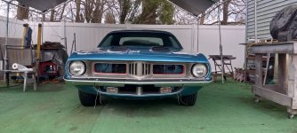

It was not an optical illusion bumper is a full 1/2" out more on the drivers side, loosened that first & had no play to push it back.20231226_125551.jpg
Passenger side20231226_125610.jpgSo I loosened the passenger side, it was all the way out, that had play to the rear, Pretty sure the whole thing should look like this.....................

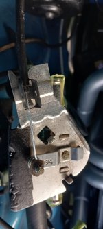

20231226_125542.jpgSo I pulled it back all the way out, 1/2" is better than 2 1/2" on one side & 1 on the other!20231226_134849.jpgUnless I get crazy & pull the drivers side brackets & elongate the holes this is it for now! 20231226_155415.jpgMoved on to the heater cable, when I got to the point the whole drivers side of the dash had to come apart to get that control out I tried from underneath, after much wailing & gnashing of teeth (thanks Jass) I finally got the screw in.
Not liking the adjustment, it will only go full open with the cable completely out of the clip, I have it barley on the edge & she's about 1/4" away from the stop, it does go full in the other direction. 20231226_151522.jpgI got lucky & fount a couple of clips that hold it down from my air vent leftovers from the 73.

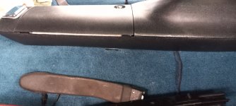

Boy this aftermarket stuff is bad, wanted to test the console to see how bad I screwed up the carpet, so I'm gathering the hardware & started to put the plate on & the contours in the plastic for it are all off, if I got the front down the back would not fit, visa versa on the front.
started grinding the edges of the plate, that was going nowhere fast so I tried cutting out some plastic, ended up actually drilling into it.
the front one the clip didn't even slide in far enough for the holes to line up, shaved some plastic off that,

I wouldn't mess with the front bumper any further. You're not likely to get it any better with slotting mount and the like. The bumper stamping is at a slightly-different angle than the actual car.
This picture looks good. Don't attempt to improve upon it!

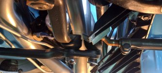

Raised up the front AGAIN & fought with the drive shaft a while, put blue thread locker on the U-joint bolts, supposed to be 170" lbs, but I could barely get a wrench on there, no way the socket was fitting, got em as tight as I could with a 5ish inch wrench?
