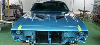

Back to the hood, after many slight adjustments in about every piece on the front end I got it pretty close, just a tad tight at the front of the passenger side, but somehow the sprung spring thing went away!. it's just a tad high, a fender shim should fix that! 20231221_144334.jpg20231221_144350.jpg
Fender is pulled to the max left.

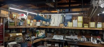

Brought the grille up from the basement, last part down there. I picked this up some 15 years ago, started cleaning that up, gotta hit the chrome with some wax to see if I will save them or put the new ones on? 20231221_163920.jpggarage is slowly getting cleaned out, one more big part hanging, still quite a bit on the shelves though. 20231221_164113.jpg

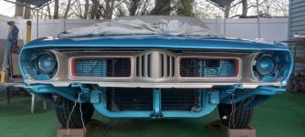

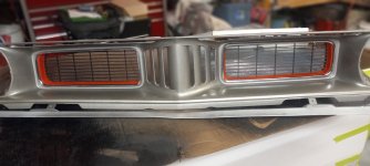

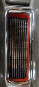

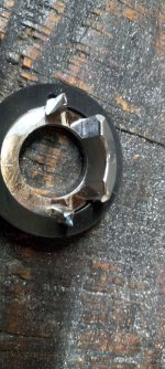

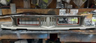

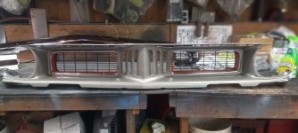

So I did a quick test fit & looked around, already short one of the insert clips that goes in the header panel, rest of hardware still to figure out! 20231222_161844.jpgSo I finished cleaning out the crud in all the black slots & polished one of the existing chrome trims, then compared to new, since I already paid for them & there was a noticeable difference I put them on. 20231222_164439.jpgReady to go on!20231222_171646.jpgNow I'm pretty sure the bumper filler attaches to the grille, but my grille has no provisions for it, might be a 72 grille?
anyway I'm hoping without the big support in the bumper I could get away without it, which would also mean I threw away another 100bucks or so! 20231222_172615.jpgAll the holes in the filler match up to supports on the grille?20231222_172532.jpg
