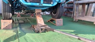

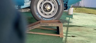

Bounced the car up & down as much as I could & started jacking it back up, rear went well.
Up front I had a hard time getting it high enough to get the ramps under
tried from the side even with a 2x4 on the jack way short! 20231214_143237.jpgWith it up some I was able to get under the K with a 4x4 on the jack, mann this is shaky stuff!
Almost at the limit of the jack I was able to slide them under & kinda roll the wheel & kick the ramp to get it all the way under.
Sucks when you can't just drive the car up!
I hope there's enough room to the fence in the back that I can at least roll it off???20231214_144109.jpgCouple of mild days coming, hope I can get it all torqued down & done under there.

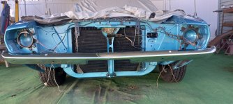

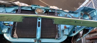

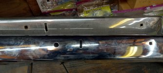

Then I opened up the new bumper, looks like the wrong bumper was on the car, wonder where that came from?
the bumper guard round hole lines up with the inner bracket, I can just use a bumper bolt there, the new one has the holes in the top & the ends for the bumper bolts & this jack slot is between the 2 brackets! 20231214_130047.jpg20231214_131040.jpg20231214_131108.jpg

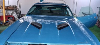

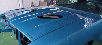

We got the hood on, a ton of adjusting to do but now I don't have to worry about the snows that will come. 20231216_162442.jpg20231216_162502.jpg

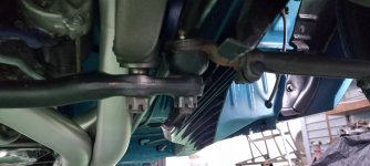

So only one piece under there concerns me, there's a gap on the pitman at the bottom, now this is an original piece as is the rod, mine had no grease fitting, he put an electric gun on it & that's as far as it went, had to back off a tad to get back to 40, I have to look that spec up again not sure if it's different from the links?
Here's the gap?
You bounced it more after it was on the ramps? The bounce is to settle the suspension, and after raising it up, it's not going to be settled.
#1 too late! I did have to jounce the wheels quite a bit to get them on the ramps?
Here's the gap?
Hole for the cotter pin is clear. View attachment 26908
Not sure why it didn't occur to me looking at the photo, but I smacked m'self in the forehead after I looked at my '74... where's the boot?! That fills the gap nicely. Yours is probably lying around there somewhere. There's supposed to be one on the idler arm too, for the record.
