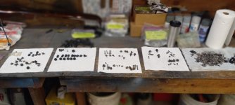

gonna see if I can round up enough hardware to get started, I have no Idea where that stuff walks off to?
I got a whole bag of assorted hardware with the Duster, and hardly used any of it. I just accepted that I'd be way ahead to just buy hardware kits from the get-go.
I bought quite a few sets for the other car, disappointing to say the least, the fender U-nuts stripped out instantly, rear valance kit had about half the wrong parts & so on.
I also bought a ton of used parts that came with hardware, now this car came to me with a lot missing, I was actually thinking of going back to the original pics to check out my problem areas.
With all that I still seem to come up short, next post is my scrounge up front end parts.

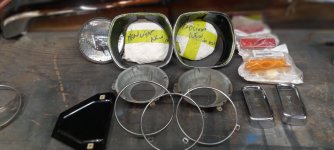

First I pulled out the headlight box, when I got to the bottom I found a better set of parking light covers, gotta dig deeper before I pit stuff together!

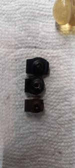

I was missing 4 of the u-nuts for the bezels on the grille, on the top 2 holes regular ones would fit, but the bottom was shorter, there was one in there but it had different threads, so I ground down a couple of the others! top other, middle ground down & bottom was the wrong one that was in there. 20231223_142801.jpgSo I go to put them on & find one screw fell right through the hole, reverted back to one I had repaired, gotta see if I can fix the other it was much better? 20231223_144444.jpg

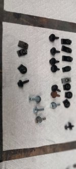

All my bags laid out, extra rear valance leftovers provided a bunch of the u-nuts!20231223_145235.jpg
Marks bolt collection provided 1 orig type rusty bolt & some new ones if I have too, my bolt collection provided 4 more, so I should have enough now to do the grille & the lower valance. whew! 20231223_153744.jpg

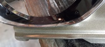

OK , quiz time, On the header panel it has 5 spots to connect the grille, outers slide in, 20231223_151212.jpgBut the middle one is a square hole & I couldn't get it to pop in there, am I missing a welded in nut there, I don't think it's accessible for a nut & bolt?20231223_151218.jpg
Try a plastic insert like used for hanging your tags.
Got lucky when I was setting up for the headlights I had an extra plastic for the adjusters & it snapped in that square hole on the header panel, wrong type & much larger screw to screw with the rivet counters!

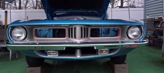

I do love the front of these cars! 20231224_163253.jpg20231224_163728.jpgI will defiantly need to mount that bumper filler!20231224_163303.jpg
Playing catch-up here... I was going to respond that you must have the bumper filler panel with the '73-up bumper mounts, but you've already discovered that. 😄 Unfortunately, there's no diagram of the filler in the parts book. I found the part number but that was essentially a wild stab in the dark on which I lucked out.
The gap in the bumper looks really wide at the driver's side end. Is that an optical delusion, or a reproduction bumper?

Didn't measure the gaps, there's some adjustment in the brackets?

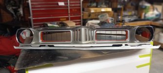

I was thinking of moving the brackets back, but that would involve a ton of work on pretty heavy metal, I will attempt installing the filler, I better not mess up that pristine grille, I will burn the damn car if that happens!
How do self tapping screws work on plastic, I will do a test someplace that won't show, if they work my worst problem will be getting the deformed ends to look decent, if not I have a ton of drilling & tapping to do!

If you're going to attempt self-tappers to hold the filler to the grille, get self-drilling screws. The factory screws were most likely Philips truss head, but being invisible it's probably not critical. Drill pilot holes first anyway--1/16" or thereabout, depending on the screw size. Do not use power tools to install the screws. That plastic is very unforgiving--you will break it. Use a screwdriver (Philips) or nut runner (hex head--looks like a screwdriver but has a socket on the end) to install the screw, being patient to let the screw tip do its thing. Again, that plastic shatters if you look at it wrong, so take your time and let the tools do the work! If you don't have the proper size nut runner or a screwdriver that fits the fastener perfectly, go get one at the hardware store (and shame on you for not having a #0 or #1 screwdriver in the case of the latter). It'll be less than $10, but even if it's $100 it's cheaper than finding another grille!
Before you drill or screw anything: Is it possible those "headliner/heater box" retainers were used to secure the filler to the grille? Look for marks along its length that match up to the fangs on, or size of, the clips.

The screws I have are called bit tip, from my sheet metal days, I just worried when it catches the threads it might split the plastic?
they are only 3/4" long, I'll test the bottom (hidden) spot first.
I have no idea about #1 or #0 screwdrivers, but I have a bunch & a set of nut drivers or my mini socket set has a driver handle.
If I drill em I could just use my regular sheet metal screws, pointy tip & slightly wider thread size.
The phillips that came with the cowl screen set were basically bit tips, look just like mine, but mine are 1/4" heads & a little longer.
I will go SLOW & be super careful I DO NOT want to damage that grille it was the better of the 2 & I saved it for this car!
Make sure to check for evidentiary marks on the filler panel to see if those clips are how it was retained. It's entirely possible there were no screws. With that said, I managed to find my filler(s)--there are three pieces on the Challenger--and there are definite screw holes with clear evidence they were used. Also, two of the three grilles I have here are drilled for the filler. One of those two definitely came from my car, since the third is still mounted in a spare header panel I bought several years ago.
Side note: When I found the bumper fillers, which I was sure I'd tossed because they're not going back--I found the black speaker grille material we'd discussed about 50 pages ago. Oy.
The reason I suggested pre-drilling and using self-drilling screws (which I could see being called "bit tip" since they look like a drill on the end) is because no matter the size of pilot hole, the tip will drill the pilot hole in the plastic to the appropriate diameter for the threads. Going by hand, you shouldn't have an issue with cracking. It's when you get impatient and grab the drill/screw gun that things start to disintegrate. Power tools aren't suitable for everything.
When you go to drill the holes, support the back side of the plastic with a piece of wood like a scrap of 1x1 or similar, just so you're not pushing directly against the plastic alone. It has very little structure or strength, so you want to spread that load against an easily-drilled backing. Gently C-clamp the wood to the grille, making sure there's no obstructions, braces, etc. in the way. Make sure it's perfectly flat to the grille. Use some paper towel between the C-clamp and the grille so you don't mar the finish.

I should have some time to start setting up to do the filler, gonna tape it on first to see how bad the ends are warped maybe tape those down for a day or two to see if they will come back a bit?
Those fillers are almost always warped. It's a miracle mine aren't, to be honest. Stretch had to find replacements for his, and it was a salt-free, cold-climate car so it most likely wasn't heat that warped his originals. Regardless, you might do well to steal Mrs. Rusty's hair dryer to warm them up and try to deform them back to shape. I was able to do that on a Rallye gauge bezel, another commonly-warped part.
On the subject of heat, don't attempt to drill that grille outside. Bring it in the house and let it sit for 12+ hours until the plastic is room temperature through-and-through. It's a lot more brittle at <50° than it is at 68°.
Hmmmm, I did not plan on removing the grille if I can get to the 3 bottom supports that need to be drilled I would do it on the car.
I will study this mess close up tomorrow!
Then take the hair dryer out to your work area and warm it up in position. Just get it warm, not hot, and only heat a little spot at a time. Don't use a heat gun. It may be too much concentrated heat and warp or melt something. Hair dryers are easy to regulate, as evidenced by millions of women whose scalps aren't blistered because their hair caught fire.
