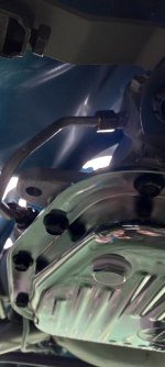

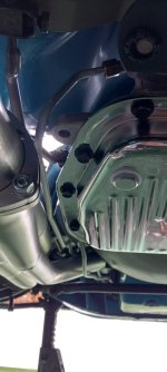

The headers, one is over & one is under, I don't think they are coming out without pulling the lines? 20231027_130228.jpg

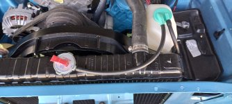

Sooooo I got a few things done, cleaned up my old hoses for the overflow & got them in..................20231028_110221.jpg

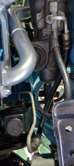

Cut a new return line for the steering pump & put that on, cut it same size as old, but looks like overkill?
the other looked pretty good so I put it back in.
I used the squeeze clamps, they didn't seem like a lot of tension, should I put screw clamps on them?

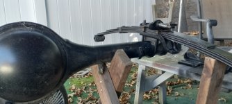

Had to paint the rear again, just sitting around it got nasty! 20231028_113740.jpg
one side the u bolts look like they cam thru prtty even, on the other both look offset a bit, more thread showing on one side, does this matter, they are just snugged down for now? 20231028_113910.jpg
Not sure if I should do the axles & brakes yet, not sure how long before I have tires to roll it under the car?
I keep putting off messing with that carpet!
Hope I can lift it off my rack once I get all that weight on there?
Lift the rear end? Yeah, you can't do that unless you're Arnold. Heck the center section goes near 100 pounds alone. Axles, springs, brakes, housing, no way. Cherry picker time. I used my transmission jack to support it until I got the springs bolted up and tires on it. Then I just put it back in.
I would try to even up the u-bolts before torquing them to spec.
WTF is that axle mounting part? One of those iso- things?
I just mean putting them in & doing the plates & brakes, that I'd rather not have sitting out all winter & it will add quite a bit more weight.
As it sits now I can rest it on one end of the springs, lift the other end (with a helper) & kick out my stand, but I'm not sure I can flip it over, maybe stand it up straight walk it around & drop it back down right side up!
I agree 100%, particularly about torque specs. Very important here.
I'm going to assume you recognize the shock plate, so the other part is the E-body swaybar mount. The end link mounts to it.
You're going about this 100% the hard way. Trying to lift an assembled rear suspension is a fool's errand, and attempting to lower the car onto it is even more exasperating.
Remove the leaf springs from the rear end completely. Install the front spring hangers on the spring eyes first--nuts toward the rocker panel--and torque them to spec. You won't be taking it apart again. Lay the spring on the ground and bolt the front spring hangers to the frame, torquing again because this is the last time. Install the rear swaybar to the frame, for good. Tie it up so the ends are out of the way if necessary. Leave the springs and swaybar that way until the rear axle is done, including center section, axles, brakes (not the fluid lines), wheels and tires.
When the axle is done--tires and all--you roll it under the car over the springs to approximately the right place. Lift one spring up to its axle seat, putting the swaybar mount in place between them while doing so. Don't try to lift the axle, just hold the spring up to it. Put a jackstand under the spring to keep everything in place and drop the U-bolts over the axle. Slide the shock plate over the U-bolts and finger-tighten the nuts just enough to hold the whole mess together firmly.
Now do the same thing on the other side.
Now you just lift the axle with your floor jack under the center. Everything goes up as an assembly; nothing can go in any direction but the one you want. When you get the right distance between the shackles and rear spring eyes, install the shackles. Make sure they're pointing away from the axle, then torque to spec. Now torque your U-bolts. U-bolts are tricky because tightening one nut automatically tightens the other. Back and forth between the two, evenly, until you reach spec.
No heavy lifting, no cherry-picker, and no kicking or other flustering about. Axle's in. Install your swaybar end links, brake cables, hard lines (yes, these are done after the axle's installed) and hose, and driveshaft. Boom-shacka-lacka, you're done.

My technique for the rear is to build it on the ground, roll it under the car, tilt up the front & bolt that in & then jack up the pumpkin to hook up the shackles, worked well on the other car.
Pretty sure that's the way I did mine, but I had it on the trans jack so all I had to do once the springs were on it was lower it to the ground and roll it under

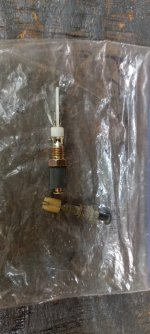

Found another door switch after I bought 2, now I have 2 extra!20231029_152450.jpgThis is up for grabs, anyone need or want it, or it will go in the next metal junk dump
