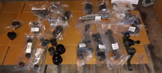

Gotta look back, I brought a front end kit, gotta go back & see where?
half the parts were china!!!!!!
even some of the moog stuff is made there now.
Everything I've gotten for A-, F-, & B/E-bodies is still made in USA. Much of the '72-older A-body stuff has gone extinct, though, as have some of the more complex F-body items. B/E are next, so get while the gettin's good.
I've got enough Moog parts here to rebuild four 1964-'72 disc-brake A-bodies, two E-bodies, and a '73-'76 A-body. With the A-body stuff gone, it's like gold now. I've hoarded it not as a scalper, but because I'm now my own warranty department for those cars.

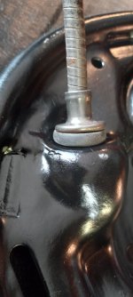

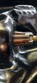

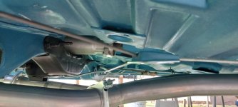

then I got the package from inline tube.............20231025_110938.jpgSo I pulled out a backing plate & tested the fit before I mounted the cables, looks correct it locked in with the grommet!20231025_125118.jpgI had a hell of a time getting it back out again, don't have a tool to compress 3 ears at one time! 20231025_125108.jpgSo I crawled under & mounted the cables, another thing out of order it was a bitch getting the clips on the rear with the mufflers right there, actually bent the crap out of one of the new ones, lucky I at least had one old one to use, cables in! 20231025_133938.jpg
I always just grab the thing with channel locks and apply plenty of cursing but I've also heard you can use a line wrench that's a tight fit and tap it toward the backing plate.
FWIW, it shore is looking purty underneath your car, mister.
