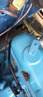

That's a hell of a place to put a fuel filter, now I know why everyone goes to hoses!!!
Now that I see where the old carb line is I'll see where that takes the other end of my new line??????????
Well, it's not like it needs to be service that often, and of course the dealer techs had hoists.

K, wormed the line down in there, not exact yet but in the general vicinity.
Now to see if the fitting even fits the carb inlet? 20231104_123813.jpg20231104_123929.jpg

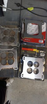

brought out the carb, tried the new plate & it still seemed to catch, added in one of the old plates & throttle opened smoothly.

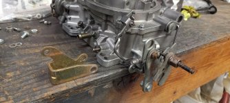

I'm gonna need some kind of adaptor here, much larger thread on the carb. 20231104_141806.jpgsticking with the carb theme, I went to put the new adaptor on & the holes didn't line up, so I pulled the yucky one off the other carb & that fit, I think I have the throttle piece in corectly? 20231104_150425.jpg

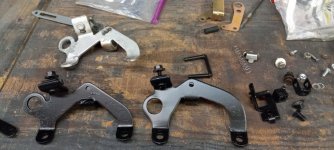

looking at my kickdown junk the black ones came with the ebay kickdown I bought to replace the one I stole for the 73 the silver is off the 73.20231104_150521.jpgthey all look the same except for the large hole, one on the left matches the 73 one, the black U shaped bracket is bent I can steal that off the old 73 one.
Which black bracket should I use, does it matter?
Figure out which one has all the parts for the kickdown and use that one.

You need a 5/8"-20 gasketed straight thread to 5/16" inverted flare adapter. Edelbrock doesn't make one, but this one should do the trick. Stop attempting to modify the line until you have the right part in-hand. All of the aftermarket brand-name ones I found were for 3/8" fuel line. Your line should be 5/16".

Both of those parts do the same thing and mount similarly. One has a bend (made by Edelbrock), one has a cutout for clearance (made by Holley). I believe the Holley part uses a washer between the adapter and the throttle shaft bracket at the lower mounting hole rather than the fancy bend. I've never set one up on an Edelbrock because I don't use those carbs.
20231104_150521-jpg.26590
Considering every throttle-cable bracket you've got there is a two-barrel part, I'll go with "none of 'em" for $400, Alex. The RH black bracket is for a '74 360, but it won't work with a four-barrel. The other two are 318 parts. The throttle-cable clamp stud is higher and further back on the 360 part.
Two-barrel and four-barrel parts do not interchange. The kickdown parts are different, the throttle-cable bracket is different, and the throttle cable is different. No amount of mixing, matching, bending, cutting, and swearing works. You'll either screw up your throttle travel, smoke your transmission, or both. I fought this battle a lot when I had automatics. The last was on my Fifth Avenue, way back in 2004, but by then I'd learned to get all the parts from the same car with the right carburetor and transmission.
I have no idea what that "dohickie" is other than trash. It's not a Mopar part and I can't imagine what its function might have been. Toss it. The weird little black bracket to the right of the RH bracket that looks like a throttle-cable clamp with an extra stud at a right angle is exactly that. It's a cruise-control throttle cable clamp. The silver one behind it is the standard clamp you'll want to use unless you're installing cruise. If you've no use for the cruise clamp, let me know.
The OE part number for the kickdown rod is 3751570. The throttle bracket is 3577561 and should look like this (except blue):

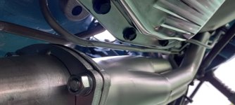

Started with the tranny lines, they were laying right on the headers in a few spots.
mucho prying & pushing & I managed to get an inch or so clearance everywhere but right at the flange! 20231105_133553 - Copy.jpg20231105_133724.jpg20231105_133609.jpgthen I tried the heat gun on the carpet, didn't help much & it burns that jute pretty quick!!!

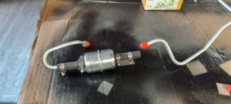

& got lucky on the fuel filter, the one I had was the right size, so I got that ready to go on when the carb adaptor gets here! 20231105_150938.jpg
