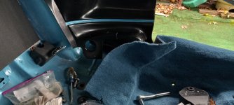

So today's intent was to lay out the under carpet seat belt wiring & then try & get the rear carpet done, went out looked at it, with the rain had no place to put the front carpet so I ran away & messed around in the boxes again.

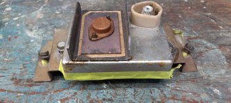

Pulled out the old controls so I could paint the mounting bracket, the goop melted a bit & had it stuck on there nice!20231030_131551.jpgI think they stripped the hole for the voltage regulator, I don't remember nuts & bolts on the other car? 20231030_131609.jpgSo it's getting close to fluids time, got the 10w30 oil, pulled my left overs off the shelf, does this stuff go bad it's been up there over 10 years? 20231030_140523.jpgREar end gear oil, I have 1/2 gal left over, but the guy who did my bearings recco'd using something a little thicker what should I buy? 20231030_141314.jpg

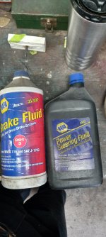

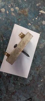

A a stupid question does this screw look right? 20231030_143039.jpgAlso need to buy spark plugs, what should I buy, there's a ton of new things out there, any of them worth it, or just go with autolite or motor craft?
I do forget what # they were?
If the brake fluid is truly 10 years old and is not sealed (foil missing/broken) I'd probably pitch it. DOT3 absorbs water over time. The power-steering fluid is probably OK, since water won't mix with it.

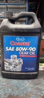

I'm not sure why you'd need to run anything heavier than 80W-90 in the rear axle. It's already heavier than the straight 80W that was factory fill. Of course, you'll want to add a bottle of friction modifier, a.k.a. "limited slip lube". It's a common parts-store item sold in small (~4oz) bottles. We sell Kendall 505-7478, but it's a horse apiece with this stuff--I don't have a preferred brand. You only need one bottle.
The original ballast-resistor mounting bolt is a flanged hex head unit. It was zinc-plated new, so if you've still got it, it's likely rusty. 😄
Unless you have a very special or exotic combination requiring something else, put in what Chrysler did. Your engine's pretty stock and you're not going racing, so there's not even a reason to vary the heat range. I've never had even decent luck with any plug brand other than Champion in carbureted Mopars.
The hammerhead at the parts counter (or RockAuto's/anyone else's cataloguing) will tell you stock number 405, which is an RN14YC. That's not the right plug number per the Parts or Service manuals. You want Champion RN12YC, stock number 404, as specified by Chrysler in 1974. The lower heat range will help keep detonation/preignition (spark knock) at bay.
I'm not sure why the plug manufacturers decided they knew better than the people that built the car, but the 1968-'70 340 used an N9Y (now RN9YC) but Champion and others have decided it now needs a plug three ranges hotter than what Chrysler installed. This seems universally true of every pre-catalytic-converter car for which I've compared the original factory literature to recent plug catalogs.

I didn't even know about the limited slip lube, I'll get some of that too!
New brake fluid!
That's the screw that was in there, I'll dig through the "spare bolts" bag & see if I can find one!

got the champion plugs the kendall limited slip fluid & champion dot 3 brake fluid.
they even showed one of those white mopar bottles for the limited slip for 3x's the price?

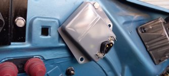

Too bad you didn't notice the nuts on the VR before painting, you could've welded the holes up and started fresh. Now changing the regulator's going to be a 2-man job, with one under the dash holding the nut.
My ECU is mounted similarly but that's on the fender apron so I can reach into the well and hold the nut making it a one-man job.
Actually, thinking about it, the Duster's VR may be the same as yours. I'll find out soon enough when I remove it to work on the firewall paint.
Most times, those sheetmetal-screw holes that have pulled loose can be tightened by just hammering them flat again. Obviously one doesn't want to go berserk with the ball-peen, just gentle tapping with a flat hammer will often do the trick. If they're too far gone, or drilled out (which may be the case with @RUSTY Cuda's car) another option is to go up a screw size.
Using nuts and bolts is a complete PITA not only during installation, but servicing as well. The Chrysler VR is pretty bulletproof, but if life has taught us anything, it's that the hardest part to service will be the one that fails.

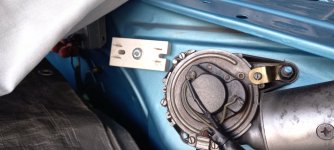

I had to actually go back to my tear down pics , couldn't find 2 holes that lined up with the bracket, now I'm scratching my head, the darn thing came off near here!
Turned out they are not exactly even & one had a captive nut & the other was just a hole in the sheet metal.20231031_130818.jpgThe reason for the bolts on the regulator was captive nut GONE & sheet metal hole stripped, it broke my heart scrapping my nice new paint off around the holes!
The back was in the cowl & not too bad to get to. 20231031_132539.jpg20231031_134454.jpgSo while I was at it I mounted the coil bracket! 20231031_134734.jpgThen I bit the bullet & started on the rear carpet exposed the rear console mount first, it's a pain trying to cut that jute padding. 20231031_143457.jpgGot the center seat belts & laid out the wiring, gonna have to see where the plugs are on the bottom of the seats to cut those wire holes, cleared the rear seat brackets & the front holes for the seat bases, gotta dig those out to do the rear. 20231031_153724.jpgSo 2 seat holes & 2 side seat belts & then I have to figure out how much to cut off the sides, there's a giant flap in the corner of both doorways.

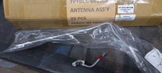

& last I thought my antenna came, I did order one from Vans, but a surprise in the box, the pump to carb lines, also from Vans! 20231102_153851.jpg

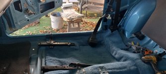

Then it was back to the carpet, got the other side of the rear done20231102_141056.jpg
brought out the seat bases for some weight on there, still a lot of ugly lumps20231102_141122.jpgThen I started making some slices in the front around the shifter, trying to leave in as much as possible, I had one spot on the other car where I could see my red metal! 20231102_144122.jpg20231102_144253.jpgPut some weight on there let it sit for a while? 20231102_154147.jpg

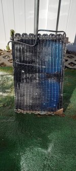

Started cleaning up the condenser coil, will need that if I buy the under hood A/C kit!
4 rounds of 2 different cleaners, I think it's clean enough to paint, may work the fins a little if they don't make me nuts! 20231102_154805.jpg
Oven cleaner works pretty well on stuff like the condenser, but watch your soak time. It's fairly caustic.
If you're going to paint the condenser, keep the paint as thin as possible. Use just enough to make it black with a very light coat or two. You really don't need to paint the back since it can't be seen anyhow once installed. The more paint you put on a heat exchanger, the less efficient it becomes. I used a direct-to-metal flat-black barbecue paint on the Valiant's radiator core. I did the tanks in semi-gloss, but they're not proving to be as chip-resistant as grill paint.

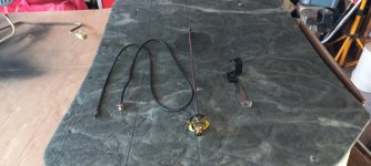

Antenna is not exact, my orig. 'Cuda had a one piece mast, it did not extend. 20231103_144927.jpg
It all depends on the car's original radio. You ordered your original car with an AM/FM radio, so it was built with a solid 31" mast. Cars equipped with AM-only radios got a telescoping mast. It's as simple as that. My first Challenger was an AM/FM car and had a solid mast. My best friend's '74 'Cuda was built with an AM-only radio and had the extensible mast.
Since you've got an FM radio in the car, extend the telescoping antenna to about 31" tall for best FM reception. If you want to listen to talk radio out of, I dunno, Ohio, stretch that baby as high as she'll go... just don't forget to put it back down afterward!
The rest is technical and restoration nonsense.
Why the different antennae for different radios? It's a physics thing involving broadcast modulation. The ideal antenna for FM (Frequency Modulation) channels is 31" because the wave amplitude, or height, is constant, with the distance between waves (frequency) being how the broadcast is modulated. At 100MHz, an FM wave is roughly 10' in amplitude or height. While a 10' antenna would mean optimal reception, it's not feasible for a car. But antennae work well in half-wave and quarter-wave lengths, so a quarter-wave antenna is a perfect compromise. A quarter-wave FM antenna is ~31". Solid masts on other makes are the same length.
