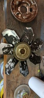

Trying to get set for this I dug around the tools I got a few years back, I think I have the puller, looks like the one I saw on the video? 20231004_152607.jpgPulled the fan blade off the clutch, next cool day I'll blast that & that pesky backing plate! 20231004_120326.jpg

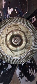

here's the stat clutch, started cleaning some of the crud of it. 20231004_120340.jpgI may need it, my clutch is a full 3/4" longer, not sure how much room I have? 20231004_155020.jpg
As I said when I posted the link, that is the exact part number clutch your car would've had new. Same with the blade. Both are factory-engineered to work with your shroud. The other clutch will put the fan too far into the shroud.

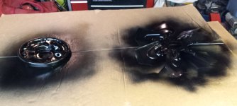

Well I hope I just blasted the last parts for this car!
Fan went easy, 1 bucket got both sides, that backing plate still took 3 buckets to get decent!
Got all of it painted up & was packing up & like an idiot I tried to move the plate & dropped it on the floor & marred up of course the side that shows!
Blobbed some paint & clear over the mess & called it a day! 20231005_160122.jpg20231005_165057.jpg20231005_160131.jpgNow we will see how far my meager skills will get me on the balancer???
