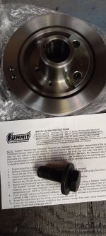

Here we go again, I'll start with the good stuff, my emblem & the seat /trunk divider jute arrived! 20231006_133501.jpg20231006_133518.jpgthe balancer & bolt also got here! 20231006_154655.jpgSo I proceeded to remove the old one, at least I got to use a specialty tool that I never thought I would!20231006_161006.jpg

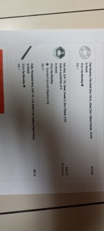

OK, I'm making my own tool I hope I got it all right, by the time I did shipping & tax on the ebay tool it was 57 bucks.
So I found a place with the rod, but no nuts & washers, then Zoro saved the day. had it all except the 3/4 washers I got 7/8" they just have to spin so I should be ok?
total w/tax & ship 41, hope I did the right thing! 20231006_174139.jpg

I would trust Rick Ehrenberg (first tool you posted, specifically listed as being "For Mopar") before whomever posted that second one. The latter doesn't say what it fits. Virtually every engine in the world has a harmonic balancer and Chevy, Ford, Pontiac, Mopar, Toyota, etc. all have different threads, never mind four-bangers, V6s, etc. That part number used to be an Amazon item number, by the way, but it no longer works. I'm also sure the Mopar balancer bolts are bigger than 5/8".
I think Ehrenberg's bolt/washer/plate setup is insanely overpriced at $43, but I don't know of a cheaper option either. For what it's worth, I have Performance Tool W89711. Proform #66514 is another option, with less adapters and hardware. The Performance Tool set is awesome (there's actually a Torrington bearing between the nut and pusher), but it (and the Proform) are a lot more than you need--especially since you're not going to be doing any more of 'em.

Whichever tool you use, make sure the threads are clean before you start, especially in the end of the crank. Make sure the tool is fully threaded into the crank before you start trying to press the balancer onto the snout. There's a lot of force on those threads, and if you pull them out of the crank, you are hosed. There's no fixing that--you're replacing the crankshaft, period.
The guy I got at summit was pretty good, he said the tool was not in stock & gave me the bolt size, which I of course screwed up at first. when the new bolt got here I checked the threads & measured it, it's a 3/4 bolt with 16 thread teeth.
He also mentioned heating it up at 200 for 30 mins. before install & a little grease on the snout.

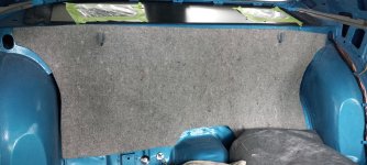

Got a few little things done, got the rear section of insulation on the roof.
20231008_110242.jpgcut the speakers on the jute for the rear deck cut & moved my dust covers up.20231008_112213.jpg

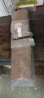

The jute for the divider finally came, now do I glue this to the back of the divider or just let it hang? 20231008_112635.jpg
