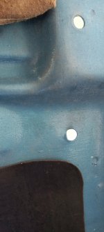

So I have 2 holes in the front floor pans about 8 or so inches in front of the hole for the seat base, there were no plugs that size in the kit does something go here, it's on both sides in front of the outer seat base.
any ideas on fabing up a plug if I need to?
the one by the black sound deadener.
Started messing with that sound deadener, if this is supposed to be for this car they are way off or I'm daffy.

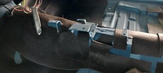

I opened up their dotted lines & tried to fit it around the shifter mounts. 20230914_150139.jpgNothing matched, after some creative cutting this is what I have20230914_150610.jpgThe razor knife is where the hole for the linkage should be.
Out back I have to cut around the back bucket seat holes & all the seat belt bolt holes, I made more creative cuts to get that one around the rear console bracket.

I'm not sure what those holes are. Pretty sad, really--I have 3-1/2 Challengers and nothing I can use for reference at the moment. It's hard to get the location down with the picture so close, though. Back up a couple of feet, man! 😁
Based on the dotted lines I can still see in the mat, I'd guess those whole sections are to be removed for floor-shift/console cars. You'd think they'd provide instructions with something like that. I plan to do my own sound/vibration deadening with stuff I got from McMaster-Carr. It's not listed as "automotive" since they're primarily an industrial source, but it's far cheaper than buying anything I've found that's specifically automotive (car stereo, resto places, etc.). It's the same stuff--I've used DynaMat, etc. in the past--it's just far less expensive. Good enough for a loud-ass factory, good enough for me. Plus, my car will pass an OSHA inspection. 😂
the dotted lines were pretty far off & I extended or added more cuts, the 2 hole bracket near the knife that's in the none existent linkage hole had no lines.

I'll reshoot the holes tomorrow, they are just in front of the seat near the door as the floor pan drops off.
both sides.
