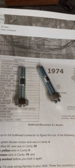

Start with the only good thing lately, I had the fine nut so I didn't need both, but at least the starter is good to go! 20230904_131206.jpg

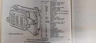

then I took a pick of the bulkhead & dug out the diagram in the 73 book20230904_134818.jpgMine showed wire colors, NONE matched what's in the plug!
on mine
#3 was seat belt (74 was belt & auto trans)
# 4 was A/C motor (74 was Tach)
#9 was starter (74 was windshield washer)
#19 windshield washer (74 was starter)
#20 A/C clutch (74 was seat belt interlock)
So my crazy markings on the A/c wire, the green could go in the safety harness that slot was empty.
But the blue was marked lower left on the main plug & both plugs had that space occupied???

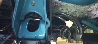

So I went under the dash again, don't see any of the interlock parts described, here's what's still hanging, wires on the left down low are the new radio wires. 20230904_131946.jpg
Basically, I'm screwed!

You're far from screwed. In fact, it would appear you've got a '73-style dash harness and the '73 underhood harness setup with the interlock sorta half-ass integrated. The big question is, if there's a blue wire in Cavity 20, where does it go? If it's not blue, what color is it?
I think you're going to be fine getting an engine harness from a '73 and skipping the interlock entirely. It almost seems like you've got some weird kitbash that someone cobbled together. I'd love to say maybe it's an early-enough car that they hadn't fully figured out the interlock integration into the wiring harness, but with such a high sequence number that's unlikely (but not impossible, either). Hell, the car's 50 years old and we can't ever know what was done prior to your ownership. It's certainly a fustercluck. 😂 We'll get it figured out... hell, we're 95% there now!

If, on yours, 9 was the starter and 19 was the windshield washer, then you've already got the 1973 arrangement for those two cavities. They wouldn't need to be reversed if you bought a '73 engine harness.
The mystery is the light green (LGN) wire. See if you can figure out the other end of it.

According to what you wrote in that statement, that is 100% the 1973 pin arrangement. A '73 engine harness is a drop-in. A 1974 harness will require you swap pins 9 and 19, then remove pins 4 and 20, leaving those two wires hanging, and plug the green wire into 4 and the blue wire into 20.
That was the pin arrangement in the 73 book, I was comparing it to the 74 you posted.

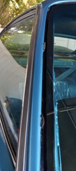

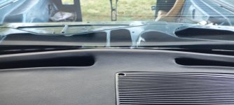

Jass I think you might actually like this guy, first a coat of activator went on frame & glass, then he rolled out the 3/8 butyl tape, he went around pressing it down & then they set the glass. then a tube of glue came out. put a bead around the outer edge & brushed it down with an acid brush. 20230905_093036.jpgAt some point during this he put in the spacers, don't look like they do much, but a finishing Touch I guess.
El humpo in the center is still there, but it doesn't touch the glass, it IS darn close!

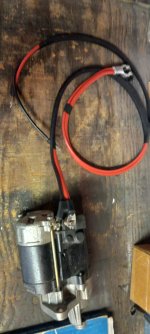

New pos. cable arrived, with a little reshaping it fit the mini starter.

Windshield leaks definitely won't be a problem. Holy cow, he didn't go easy on the sealant, did he? I've never used any sealant a'tall, just the rope! Oh, the "spacers" are actually setting blocks to correctly align the windshield top-to-bottom. Those come with the rope seal. Once the glass is in, they're extraneous. No reason to leave 'em, but no reason to pull 'em out, either. The moulding should miss 'em by a mile.
Complete exhaust system is due in friday, now if the weather would only cool off I could get some hours in out there!
I think the battery cable is spaced for the posts to which the adapter is bolted. It's on, so it doesn't matter. I think you want the adapter in place on a small block anyhow. On a big block, it doesn't clear the block.

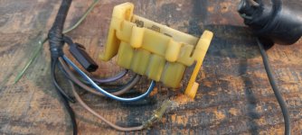

So in prepping for the arrival of the harness & the fact that it's still 95 out there I put the A/C on blasting in the garage & did the repairs on the forward light harness.
After that I double checked all the wire colors to the 73 book again, your research is spot on, the only mismatch was #19 (on that plug)20230907_135954.jpg
But & the big but is, it did work in the car, But, did they splice it somewhere else?

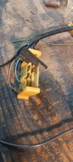

So I pulled out the spare harness to see if the clips can be changed.
First one came out easy, but would not lock back in (if it came out that easy it may not have been locked to begin with)
Pulled out the gasket & fiddled around & found if I wedge a tiny round file in the spreading side I could get em out, plugged it back in & it locked, tried one more to be sure & that worked too, so as long as the new harness has the same clips If I have to move any I think I can without doing harm to them.
20230907_135834.jpgWorst case, I noticed the A/C harness for a 71 is just 2 wires & on one end they both have those clips so I could buy that & make a splice if all else fails!
