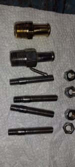

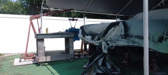

I added the little spreaders that came off the chrome ones, figured it couldn't hurt to spread the pressure, I had flattened out all the bolt holes when I was cleaning them up. 20230805_143430.jpgMoved inside & got a few coats of SEM on the light insert, that's done, cept for a few scratched areas, which I probably could have puttied up it looks pretty good! 20230805_151309.jpgThen cleaned up the hardware I pulled off the manifold, the studs I defiantly need the other fittings not sure, I forget if that little off shoot on the one went anywhere, the one on the 71 manifold does not have it?20230805_154340.jpg& finally dumped out the buckets of hoisting hardware mark had, have to get the motor in the air so I can finish off the back, cleaning, painting & freeze out plugs.
Not sure where I should hook up to, I'd like to drop motor & tranny in together! 20230805_151241.jpg
I pulled an engine/trans together once by myself. I ended up with it as high as it would go and tilted basically straight up and down to get it over the radiator support. Would have probably worked better with help. I went back to dealing with the engine/trans separately, at least as long as I have to do it alone.
I've seen recommendations to raise the rear end of the car up as high as you can so the tailshaft has more room to tilt. Alternatively you could drop the k-frame, bolt the engine to it, and come up from the bottom. That never seemed like it's less work to me but I've been assured it's easier that way.

OK finally remembered to look for the bolt hole, it is there, but lining it up with the one on the inner fender it's about 2" off the hole in the tray, still in the recessed area so I can just drill another hole! 20230806_122811.jpgSo hoist is rigged, for now just took the weight off & it seems pretty level.
1st Question, the only bolts I could find for the hook up to the plate were front bumper bracket bolts, are they strong enough for this? (the black ones..............)20230806_131815.jpg
Weight off the stand20230806_131832.jpgNow I'm looking at the extension of the lift, not sure how much higher that will go, I have the car up pretty high (top of the jack stands)20230806_131923.jpgCar is way up?20230806_132314.jpg

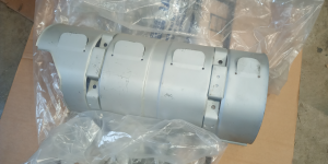

So the other bumper filler I found looked a bit cleaner that the one I put on so I switched that out today..........20230806_141508.jpg

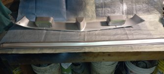

I hope I can make it right with something in this mess! 20230806_152436.jpg& finally dug out the lens & covers for the parking light insert, worn but not too bad? 20230806_152630.jpg
Got the extra chains on, slowly lifted it up, she spun a little but all 4 chains are nice and taut so I removed the stand20230807_132949.jpg

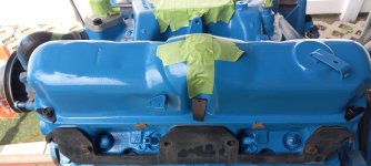

Cleaned it up a bit & got the freeze out plugs done, got lucky that big middle one was just a bead of silicone, not JB weld! 20230807_130649.jpg

I also have 3 small freeze outs in the kit, but did not locate any on my block, are they for a different engine or am I missing something? 20230807_140110.jpg
