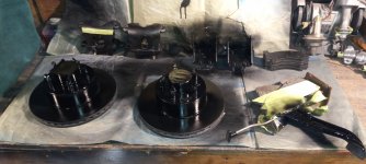

Got the tray boxed up & looked around, not much left to do in the nice A/C'd garage, I may have to force myself back out & work a bit in the heat, so I figured I could mount the front discs & brakes, so I dug em off the bottom shelf & what a mess, ended up having to repaint half the stuff! 20230729_160053.jpgI will remove the paint from the brake area!

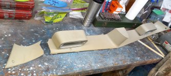

Got the plastic piece flat enough for paint & shot that.............20230729_134031.jpg20230729_152800.jpgThe more I look at it the more I think it's the wrong piece, could swear the radio has both knobs on the left side????
Does the radio go into this or in from the back?

Then I started bringing the front wheel/brake parts & tools out, sat comfortably in the shade & proceeded to mount the drivers side, caliper fought me a little but finally got it mounted.20230730_123819.jpg
Passenger side was worse, could not get the caliper over the pads, ended up taking it into the shop & squeezing it down, I hope I didn't kill it, after that it went on like it should?
Should have painted the surface by the dust cap I guess I thought it was a mating surface! 20230730_135359.jpgDecided to leave the paint on till I mount the wheels, back side will probably rust instantly.

I'm wondering if the paint might be causing the stiction that gave you trouble putting the caliper on.
I'm not going to ask you why you painted the braking surface now, but I've seen people put sand paper between old brake shoes and the rotor, then spin that to clean up rusty surfaces.
The rotors on my GTI basically rust to the brake shoes when it rains. After a short drive they're back to normal.

Got the plastic piece flat enough for paint & shot that.............View attachment 25832View attachment 25833The more I look at it the more I think it's the wrong piece, could swear the radio has both knobs on the left side????
That is, or rather was, an exceptionally rare non-radio dash filler panel until someone cut it for a radio. All E-body factory radios had a rectangular faceplate that housed the knobs, dial, etc. The dash bezel had just one large rectangular opening, with a lower cutout that cleared the 1970 8-track's opening. There were no holes for knobs or thumbwheels as those were enclosed by the faceplate.
There are only four E-body radio faceplates of which I'm aware: 1970 Challenger (ribbed, with or without radio), everything else '70-'74 with or without radio.
This is the most-common unit:
This is the 1970 Challenger unit:
This is the non-radio version that yours once was:
topic=11031.0;attach=96647;image
It's unfortunate that yours got cut (as did, I assume, the one in my parts Challenger). They're literally worth hundreds of dollars in good condition.

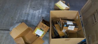

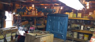

Located the hardware for the E-brake assembly, will paint em up tomorrow, consolidated a few more boxes, now this is the second batch to hit the recycle bin...........20230731_151143.jpg
