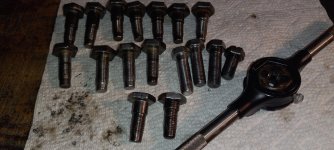

So I finished cleaning up the bolts, ran them all through the die the car ones did not go easy & actually did some new cutting, the bolts I found almost went thru by hand, I guess their die wasn't as sharp? 20230715_151221.jpg

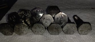

Well I have 13 bolts & 7 different #'s
Some at least look like the same bolt, guess I have to lay out all the parts & see where each type goes, some have longer sleeves than others & 4 with no sleeve.

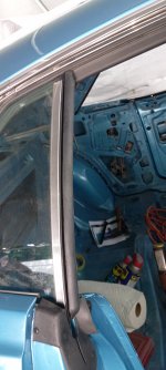

On the good side I got the new rubbers in the quarter windows, one on the bench was a battle the one already on the car slid right down, I did oil both up. 20230715_142458.jpg20230715_142346.jpg20230715_142334.jpg

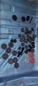

& brought out the goodie bag of floor plugs, think I have more plugs than holes? 20230716_143326.jpg
Orange I know are for the shock towers, the plastics mainly firewall, the rest I'll fit by size.
Floor almost there's 2 small holes in front of the seats, no size plug for those? 20230716_150246.jpg

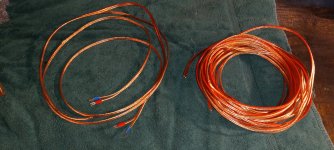

figured I'd get the speaker wires ready, rolled out a couple of pieces for the dash & put the clips on, went out & rolled out for the furthest rear speaker (with plenty extra) & then was just about to put the clips on when I realized I didn't want the extra footage back there, so that job ended.

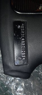

Then I went to put the vin tag in, trying to get everything ready when the radio comes.
Well neither rivet grabbed, so I glued the friggen thing in rivets & all on, when that dries tomorrow I'll flip it & drip some super glue on the back of the rivets & pray.

An RTV type product on the underside of the rivets works best. GOOP or E6000 work best. Let it cure overnight and you'll have to chisel it to get it off.
I'm short a P, I used GOO on the topside, under the plate & in the rivet holes.
I was thinking I have some JB weld too, maybe that on the back side?

yesterday I got the speaker wires ready, dash ones I could clip now I'll do the rears when I run the wires back there so there's not a ton of wire dangling around.20230719_145904.jpg

The vin tag seems to be in tight, the goo came out the bottom of the rivet holes, those have to stay in! 20230720_170512.jpg
