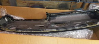

The dash pad arrived today, now if I can get 1000 other things done I can put it together.
A little rough around the defrost vents, but I don't think it will show?20230707_161658.jpg
There was some padding here & there on the back of the old one have to see if it's needed & what I can use for it? 20230707_161751.jpg

The defroster vents were pretty awful on my original dashes, too. That was part of the maybe-too-accurate aspect of Bob's pad that I mentioned. That area can be trimmed with an X-Acto knife if it bothers you, but I think once it's installed you'll have to know it's there to see it.
I may call Bob and see if he's buying cores. I'm up to six E-body dash pads as of last night. I've gotta start thinning out my inventory!
