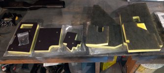

Laid out some of the insulation that came in the kits...........
fire wall with the push pins I think & back of kick panels
20230704_132332.jpg dash jute, what layer does that go on? 20230704_132559.jpgfire wall set with all the repeat heater box gaskets20230704_132359.jpgfound a plate light set too, I had one & made the other already. 20230704_132625.jpg3 sets of ralley mirror gaskets20230704_132716.jpg

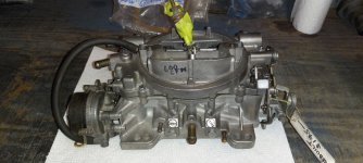

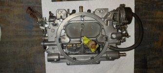

Below is what I've got. Not sure which number this one is but they're both basically the same
I would stick with the Eddy you've got.
I've got a 6090S and a 6322S
The 6090 is a '72 400HP for Federal emissions unit and the 6322 is for a '73 440 truck, also Federal. Both are carbs worth knowing.
The large elbow on the lower right that points down is one of the connections to the vapor canister. The other is a vacuum port on the front of the baseplate.

If you just bought the carb and it's new, I guess I'd say run it. Edelbrocks are some of the okay-est running carbs straight out of the box. People who don't like to tinker love 'em. They're very simple carburetors to rebuild, and there's not much tuning possible, much less required. For cruising and ice-cream runs there's no reason not to use it.
If the Edelbrock is used, opening it up for inspection would be a good idea. Edelbrocks corrode badly if they sit with modern fuel in them for any length of time. The float-bowl baffles and float arms are made of the cheapest steel extant and they're very rust-prone. I had one back around '01-'02 that the rust had galled to the float bowls so badly it couldn't be cleaned. It even got past the jets. I ended up giving it away, and I think that person tossed it.
Personal experience: When I had my '73 340 Challenger, I listened to all the morons that said to get rid of the ThermoBog and put a Holley on it. It drove pretty well, but not as well as the small-primary spread-bore TQ. Under full throttle, though, it was night and day. The Holley simply couldn't feed the engine enough air--it started nose-diving at about five grand. The TQ would pull right off the end of the tach. The Holley also didn't have that distinctive four-barrel roar that's unique to ThermoQuads and QuadraJets (even a Six Pack doesn't do it). Fuel economy wasn't as good either, though 17-year-old me didn't really care about that so much. It's really a hard carb to beat.
Now, with all that being said:
ThermoQuads are a bit of a bastard to rebuild for the uninitiated, so if you buy one that's not already done it's not a fun job. There's a special tool required to get the secondary air doors adjusted correctly. It can be worked around but that's a tricky process. Plus, you have to buy a carb, an (expensive) rebuild kit and floats, then do the work before you even get to tuning the air-door opening or linkage adjustments. ThermoQuad = work.
Edelbrock Performers are a 2-piece design and extremely simple. The longest part of the rebuild is the soak/cleaning process. Assembly can be done in half an hour by a newbie, and there's rarely little that needs adjusting other than the idle mixture screws. Jetting is usually a fool's errand; at most you might need to fiddle with the accelerator pump shot if you have a stumble. Tuning and rebuild parts are readily available new and at reasonable cost, which is absolutely not true of ThermoQuad.
Long story short: If the Edelbrock looks OK inside or is new, it's probably the better option for your build.

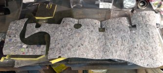

Then I forced myself to work outside in the heat a while, kinda matched up the holes in the insulation to see where they go.20230705_122304.jpg
there's one more knock out near the round hole not sure if my car needs it in or out, wait till more stuff goes in to see if it's blocking anything? 20230705_122311.jpg

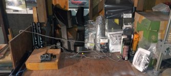

heater box & defrost vent in! 20230705_144455.jpgSo that got me an almost clean bench, so I cleaned it up & sorted out a bunch of the new stuff on there so I can actually see it & don't order over again!!!20230705_150531.jpg

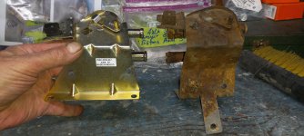

& the old heater valve was in the box with the blower, so I compared it to the new, looks like I have more sheet metal work, the bracket is way different, the pipes & working section look the same.20230705_145014.jpg

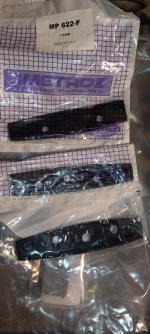

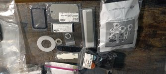

heater box leftovers, 2 foam strips I could not figure out where to place, not mentioned in the list that I could find & an O ring & retainer, not sure where they go? 20230705_150231.jpg
The carb looks OK on the outside. I doubt he ran it, let alone letting it sit with fuel in it after rebuilding it. It wouldn't be that clean.

the old heater valve was in the box with the blower, so I compared it to the new, looks like I have more sheet metal work, the bracket is way different, the pipes & working section look the same.View attachment 25652
That looks like a B-body valve to me. Good ol' Four Seasons, I'm sure they just superseded the Challenger part to the Charger one. The OE part number was 3502723, which crosses online to the one you have (Four Seasons 74643) but obviously isn't right. There are two listed on eBay with the right bracket, but they're not giving 'em away--especially the one in the Mopar box. The other does have the OE number stamped on it, though.
I'm not sure what the story is, but that's a bit of an odd duck. It only appears in the 1973 parts book, and only as very late production. My '74 uses a very different valve, which is what was also used prior to the one you have. It's also far more expensive, and in the case of the one I posted, it doesn't even include the mounting bracket! I have three NOS ones, which is good because I now have two AC-equipped Challengers.
I believe the your old valve is what was available from Four Seasons and the other aftermarket manufacturers to replace the one on my car. It's very possible the OE one failed and was replaced with a parts-store unit somewhere along the line. I have vintage Murray and Four Seasons catalogs at work; when (if?) I finally get back I'll try to find the numbers they used for the direct replacement of your valve.
If nothing else, you should be able to transfer your old bracket to your new valve. The two parts are just held together by those four tabs forming a circle around the pivot point of the cable connection. Not easy, but better than trying to fab a new bracket!
heater box leftovers, 2 foam strips I could not figure out where to place, not mentioned in the list that I could find & an O ring & retainer, not sure where they go? View attachment 25654
Go on Detroit Muscle Technology's website and see if those parts are listed individually. If so, it should tell you where they're supposed to be.
While hunting thru my pics today I found a shot of the O-ring & retainer, they go on the drain tube at bottom in engine bay .
I'll check out switching the mount.
Pretty sure the carb was rebuilt & shelved, there was a few of them on that shelf & it was in the house.
