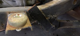

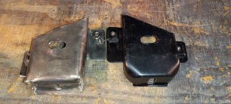

Got the corners & the nuts welded, not pretty but functional, & where it will be no one will see it for another 30 years! 20230616_132334.jpg

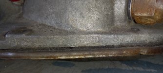

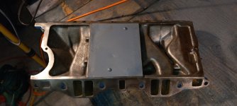

So dum dum is getting the manifold ready, cleaned all the mating surfaces, may need some goop under my gasket, there's a little pitting here & there? 20230619_142457.jpg

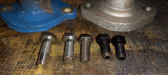

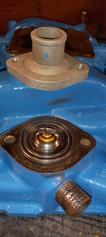

So I pull out the new stat & housing, paint em all up & got to put the bolts in & the new one is so much thicker than the old bolts were too short, found on perfect one & 2 longer ones, but they bottomed out before getting tight, so instead of running down to the hardware store I sat there with my little bench grinder for quite a while to shorten one bolt! 20230619_162149.jpg
Now I'm pretty sure I have the stat in the right direction, can button that up when the paint dries on the new bolts!
Old one only fit in the housing with that side up, am I correct on the direction? 20230619_145605.jpg

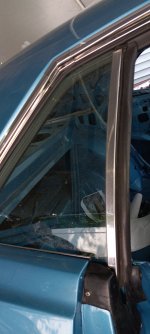

So after I got the hardware in for the quarter window I decided to stop, I just ordered new wipers for the front edge & looking at the one I put in you can't get to the bottom rivets with the glass in............20230619_133811.jpg
Now on that one I may get lucky I can slide the old rubber up & down maybe I can just slide in the new?? 20230619_135810.jpg
So I guess the stat is the first question, is that the correct direction?

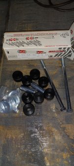

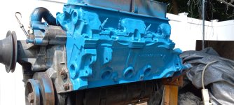

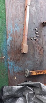

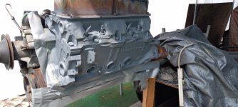

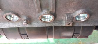

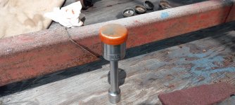

Then I decided to tackle the freeze out plugs, now the ones I pulled out were not as deep as 2 different howto videos showed. 20230620_125409.jpg
Just to be safe I put a light coat of copper permatex on em.........20230620_142835.jpg
2 to the front look about as recommended, the rear (on the right) I may have pounded once too much, I hope it's not a problem? 20230620_145302.jpg

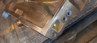

have to reverse for a moment, I punched holes in a couple before they would budge....... 20230620_125425.jpg
& there was some nasty lookin stuff in there I was going to dig out the power washer, but I brought the hose over first & I think that was enough. flushed it out in every direction I could hit till it ran clean, then pulled out the heat gun & dried it all out, cause it will be sitting quite a while longer. 20230620_132628.jpg
& that's where it goes bad, the plugs on the heads are smaller & they had ONE in the kit, I need 5, so I'm short 4, hope I can buy those separately, I am getting a little upset that about half the stuff I get is screwed up!

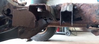

But to get his 8 to 10 K for it he'll be working hard, some nasty repairs to remove on both sides!20230621_143006.jpg20230621_143015.jpg

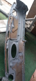

Dash pad is boxed, did my best to protect the ends, cardboard & tons of bubble wrap, should ship out Friday, my son will help with the shipping setup & he works from home fridays.
Yes, the "pill" has to be in the hot water to open. The stat itself sits in either the intake or the housing, depending on which one has a recess for it to fit in.

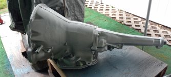

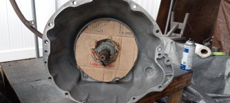

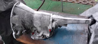

Yea, no disasters today, cleaned up the trans good enough to take paint I hope, first I used left over coil cleaner from my A/C days, great on aluminum , then fantastic then metal wash & finally wax & grease remover!!!!! 20230622_132841.jpg

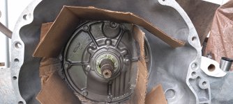

made up some really rough cardboard covers, on this I had to shoot half at a time20230622_145344.jpg

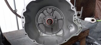

This one I had to spin as I went, painted my hand pretty good! 20230622_150643.jpg
Now I have to flip it & get the bottom & order my new chrome pan with a garsh darn drain plug! 20230622_151212.jpg
