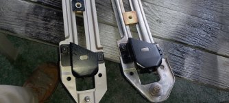

Ok major rant time, after messing with the passenger quarter window for quite a while I get it in all the slots & groves & it stops about half way down, wasn't a down stop problem I couldn't see it hitting anything, But & it's a major but that made me take a closer look at the downstop, I should have realized it was wrong when I had to pull the guide to put it on (bolts in from the back) adjustment needs to be from inside the car!
Sooooooooooo I pull out everything get the other crank mech. & start scratching my head.
I think I had the wrong crank mech. in, but now to the down stop I lay them out, one I got off ebay said pass. side I swear I had mine marked right now I pulled all my markers off so I have to guess.
The way I had it with the stop on the wrong side the one on the right.
Laid em all out the one I had marked drivers side on the left, ebay in the middle & my pass side on the right clearly I have the opposite down stop,now the only difference is the angle cut on the guide & stop is there any chance there's enough adjustment to use the 2 on the left for both sides??? 20230614_144228.jpg
It is a royal pain, even with Dons help we struggled to get a couple of screws in the pass door, but this is just nuts, I'm taking a break & then attempting one again, at least to confirm which side the crank mechs go!
My gut instinct says "probably not". If Chrysler had seen a way to save a buck using the same part on both sides of the car, they likely would've. We're talking about a company that ran the same iteration of sidemarker lamps for nearly 20 years and the same armrest bases from 1966-2003.
Thanks for confirming my plan to pay the shop to put the glass back in my car is the right idea.
Part of the deal with my car as well. All the side glass was in it when it left; he said it would all have to come out. I told him it all had to go back in as well, and he indicated that was his plan. I'll have to do the final tweaking, but that's the easy part.
Guess I'll have to figure out a down stop for the one side, if I've cooled down enough I will try to get at least one side in then at least I know which one is missing.
A shame my missing piece didn't reappear the day after the ebay one came!
Looking at the FSM, it appears the shorter angled section at the bottom of the regulator faces the front of the car (toward the door jamb). The drawings really aren't clear enough to tell you which side of the car they're illustrating. One really looks like the left side, the other the right. Without a car here to eyeball, I can't help you further than that because I've no idea the orientation of the fasteners in the quarter panel.
My WAG is that you have two lefts and a right, which aligns with your labeling of the originals. Looking at those diagrams and the down-stop bracket more closely, ain't no way you're going to successfully use the LH down-stop bracket on the RH side. It's literally a mirror image of a complex stamping. It would be easier to fabricate a new one than it would be to reverse the features of your extra--not that cobbling one from scratch would be the least bit easy.
So the ebay one marked passenger side was actually a drivers side, DAMN!
At least now I can attempt the drivers side & then start messing with a home made downstop!
OK I'm the idiot! Looks like I was missing the drivers side all along.
fought me a bit but I got the pass side in & adjusted pretty close.

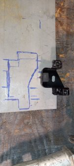

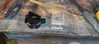

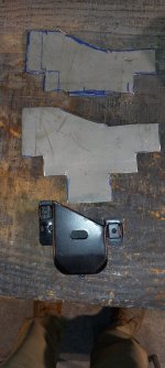

then I moved in the shop & started on my rube goldberg down stop, had some 20 guage left from car patching Now I have to turn this into one of these! 20230615_144937.jpgfirst attempt, got it all cut out & realized I needed another 1 1/4 to fold under the bottom! 20230615_150241.jpg20230615_151124.jpg2nd attempt20230615_151301.jpg20230615_151857.jpggot it all bent up & was pretty close, just a tad too long at the bottom20230615_162325.jpgGot that trimmed down & drilled a bunch of holes now that I have half my tools strewn all over it was time to clean up a bit20230615_161845.jpgSo all that's left is to weld on the nuts & weld the lower corners, shoot some paint & put in the rubber stop, which amazingly came out of the old one with no damage! 20230615_161925.jpg
