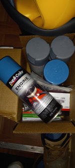

Paint also came, trying dupli-color this time?
That's been my go-to engine paint for many years. It's quality stuff.
I recently found some of the "correct" original paint codes/mixing formulas for Chrysler's engine paints and am looking forward to trying a couple of those: Corporate Blue on my Challenger engine and Chrysler "Hemi" Orange on a 340 I'm building to 100% OE 1970 appearance.

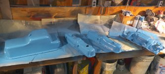

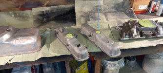

Got the engine parts ready for paint, if I got this babby a touch cleaner I could have clear coated it! 20230609_153646.jpgat least I taped off the rubbers, the other guy painted over everything! 20230609_155959.jpg2 coats a prime & 3 of the blue, blue thru a whole can of blue, maybe my 2 light coats weren't that light? 20230609_170638.jpgI guess now I'll have to start on the block!
I wondered for a second if you had painted it cast-iron gray, I've got to admit.
The "last guy" might've been Chrysler. Valve cover grommets were painted from the factory...
...and that's the reason why the grommets were blue. Chrysler (and everyone else) painted the engine fully assembled to conserve both time and paint. Everything got painted at once; even overspray was likely to land somewhere on the engine.
