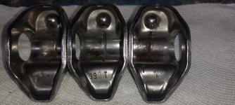

but even though my main hardware is local owned, it went to ace a bunch of years back, but the people are still pretty good & helpful? Anywho, here's the rockers.
you can read the #'s pretty good but just in case, the worst is a T 310 (l) & the other 2 are 39T (r)20230529_123145.jpg
OK dummy question again
I assume the different #'s mean they should go in specific places I think I have 8 of each soooo where do they belong on the shaft?
Now if these won't be a problem then never mind that request!
The ones marked L goes on the Left and the ones marked R goes on the otheR side.
L and R as in per cylinder pairs of rockers. They should form a V on the valve side.
Just like the two on the right in your photo.

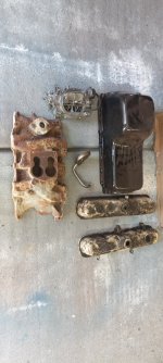

I guess my days of cleaning up 50 year old nastiness are not over yet, went to see Jerry Stien , he wasn't 100% on the oil pan, I wasn't sure about the pickup & not sure if I can make the manifold useful again?
Got a rebuilt carb & some nasty stock valve covers, for 500 I think????? I did ok? 20230530_162506.jpg

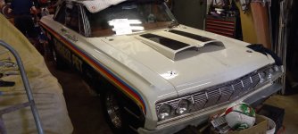

A little mopar history, He's got another one next to it but it's all covered up & another in a trailer.20230530_145517.jpg20230530_145528.jpg
That's a truck oil pan and pickup. It won't fit your car. Those were the same valve covers I had at one point, but mine were still blue. Mine are definitely gone, though.
OK Jerry wasn't sure about the pan, looks like I'll have to go aftermarket on the pan.
You think that manifold can be saved, I'm going to set up the sandblaster in the next couple of days ?
