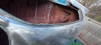

Different set of tools for this type of work..............20220320_133129.jpg
Still some highs & lows but the worst of the ripples are close20220320_145944.jpg20220320_150004.jpg
The biggest "cave in" area is much better in depth & less oil canning!

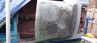

Got in a few rounds on the big dents, the tin canning on the drivers rear roof tightened up nicely, it's a little tighter around the dents, but I've created a really touchy one just behind the crown up front, I'll keep working the big ones & hope that tightens up20220321_154502.jpg20220321_154515.jpg
There is defiantly improvement, still LOTS of work to do on it!

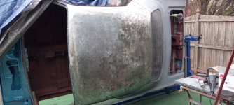

Think I'm getting close on the roof, got lucky & tried putting a pin with some metal on it(a used one) & put it over one of the holes I popped with a longer heat cycle, then broke the stud off & ground down the head & wa la the hole was filled, so I did the rest of those, then out came the lump hammer & I tried to straighten up the innner roof supports, got em pretty close.20220322_172906.jpg20220322_172923.jpg
So now I'm looking at the two areas that are still oil canning a little, with great trepidation I started banging outward with the rounded top of the lump hammer, holy crapoli it worked on the real sensitive canning spot, so I tried a little in the big dent area, I think that helped some.20220322_172719.jpg
still off a bit, but much smaller area & less gap, again the top gap is where the roof curves away.
Gonna wait till my friend can get over & see if he thinks I can do more bettererererer or if it's putty time? 20220322_172641.jpg

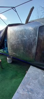

So each time I've been out I've been taking off another area of por 15, when that's all off I'll go to the less aggressive cleaning wheels to finish it up.20220322_172959.jpg

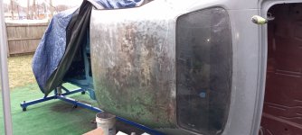

Got back from mom's rehab around 3, my intention was to stay out till dark & get the rest of the roof clean, well I ended up going back to 24 grit to get the thick por15 off, then stopped around 4:30 for a quick bite, went back out started on the 36 grit & by 5 it started raining, well bare metal & water do not mix, so I pulled the tarp over & dried off the few drips that got on & then cleaned up for the day! the top front I got the 3m wheel working a bit, have to do all the rest after I get most of the black off.20220323_164528.jpg20220323_164544.jpg

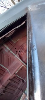

What I hope is the last of the rust repairs needed , the window channel & what was a pin hole 14 years ago, I'll have to cut out a small section there!20220323_150755.jpg20220323_150857.jpgThat's up a few inches from the bad channel above the drivers door.

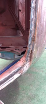

Just under the rust hole I found a screw in post & it looks like a previous repair around it?
Another screw in same spot other side, but no sign of other work? the rest of the factory studs are there. 20220325_175941.jpg
pinholes in drip rails are the one thing that terrify me as i KNOW that rust started inside the framework and rusted its way out...which means theres other issues that need to be adressed.....its the reason my 58 ford will end up with its entire roof swapped out...
It's not uncommon to see a variation in reveal clips retainers. I did an original-paint '70 Duster a while back that had one entire side with the clips retained by studs along the top, and the other side had screws.
Most I've seen were with screws, though.
Drip rail rust... One of the toughest things to completely eliminate. The double layers of steel, multiple deep spot welds, and a natural place for water to creep in and stay makes it tricky.
Unless the steel is spotlessly clean to begin with, I do nothing less than sandblasting to a white finish, then a good coat of epoxy primer immediately after, even if it has to be done with a brush. A brush-coat is preferred, really, as you can brush it in where a spray might not penetrate.
