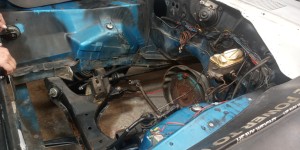

Engine is on the floor now.
For my next trick I'll pull a rabbit out of my hat - I mean, I'll clear a space to store it for now and get the 360 up in front of the car.
I'm going to try to get more of that black rubbed off but the paint under it is kind of beat in places from years of engine swaps. There's no way I'll make it look better by spraying some random blue that won't match no matter what the cap color leads me to believe so I'm unsure what comes after the cleaning.
Wal-Mart's Super Tech carb cleaner used to be a pretty effective paint remover. Used sparingly, you might be able to get some of the Camaro out of the engine bay. Work expediently, though--I let the stuff soak a bit and it took all the OE paint and primer off my LeBaron's entire engine bay, right down to bare metal. That stuff and a putty knife were all I used.
I'll look into that. Really don't want to go to Walmart though.
I had good luck with Goo Gone before. The inner fenders used to be all black but a lot of it came right off.

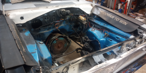

I moved the car around yesterday to get the motor into a far corner. It's pretty darned light now.
I plan to hoist the front end tonight so I can roll the trans out on the jack. It's peeking out right under the rocker panel.

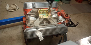

I bought a set of Holley cast aluminum covers today so I will have a set of Moroso valve covers for sale, or they will go back on the wall. I think I can get a decent $$ out of them - need to research.
I get the whole "racing/lightweight" thing, but that seems exorbitant considering the finish issues. On the flip side, finding a set without hammered flanges is tricky due to their fragility.
While I have no problem using Moroso parts when needed, their undying need to splash their name all over every single item they sell is off-putting to me. Just because I want your parts doesn't mean I feel a need to clutter my engine bay with advertising.

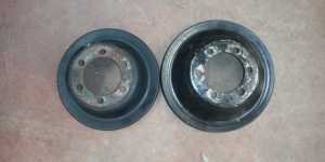

Also figured out why the engine tended to overheat while I was putting the parts away
The one on the left is from the Duster the other one came on the road runner. Both two groove.
Maybe yes, maybe no. It's definitely an underdrive compared to the other. But it was enough to cool something or they wouldn't have made it (although it may have been paired with a smaller pump pulley as well). Also, fleet/cop cars used different water pumps with less vanes which move coolant less quickly, along with 5-blade fans as opposed to 7-blade (a situation one also finds on trucks). If I had to guess, the small pulley is from a manual-steering application, possibly an LA or even Slant. A lot of pulleys interchange based solely on offset, which of course doesn't mean they're the right diameter.
Of course, I've written an entire thread about how parts-store thermostats don't flow enough coolant for the cooling system to work properly. That's my go-to if an engine runs warmer than expected, and the whole thing arose out of a situation with Kev's car running warmer than he'd like. It won't run right at stat temp now, but he lives in Atlanta so it's not surprising it sees low/mid-190s in the summer with a 180° stat.
The best bet is to get a set of pulleys off the same engine if possible. I've grabbed sets out of boneyards over the years and either zip-tied them together, or at least used the tiny colored zip ties to color-code them. The pulleys on the Valiant both had yellow zip ties, so I knew they were a "matched" pair, in this case from a manual-steering small block.
