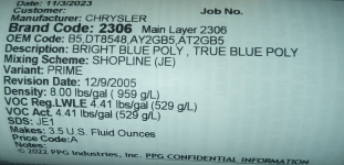

The code is GB5 if anyone has suggestions that might work. Now that I've rubbed the black off it looks more like EB5 because it's "clearer" and a lighter shade in places.
The first digit of the paint code does no good if you call a paint store. I'm not aware of a manufacturer's formula book that shows that first digit because it's technically not related to the paint code, it's simply the first year the color was used (E=1969, F=1970, etc.). When you go to order paint, you tell the man "I need your finest rattlecan of 1971 Chrysler code B5" because he won't have a listing for GB5.
There are three different B5s of which I'm aware: 1969-'70 (EB5), 1971-'73 (GB5), and 1974-'75 (JB5). The 1969-'70 color is darker but more vivid or intense than the later two versions, which themselves don't match. 1974-'75 is the palest and most subdued of the three, but it's pretty close to the '71-'73 version. Both are paler in comparison to the first version.
Paint is $32.05 per bomb, tax and all. It's acrylic enamel so no clear coat needed.

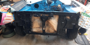

Don't worry it's nowhere near as nice as this photo might lead you to think.
Yeah I noticed I missed a spot, ditto the underside and bottom of the yoke. Caught those up once I looked at it under a light after the photo.
But, better. There is some cracking that was also in the white crap paint that I didn't sand/wipe all the way off. Oops.
It's satin, because that's what I found first. Maybe should've kept looking until I found flat black. No matter, that part is done. I'll mask it in the other direction tomorrow and we'll see how the spraybomb B5 works out.

I need to figure out how high I will need to raise the car to put the engine in from the bottom and decide about that too. And then there's all those clutch parts.
Measured from the bottom of the k-frame to the top of the rad support ~ 25"
Measured from the ground to the surface of the cart I hope to use if I drop the K-frame = 8"
Estimating the engine/kframe height at 25" means I would need to lift the front of the car about 36" to get the loaded cart under it. If I could go straight under the front, which complicates everything because the crane needs to stand back further that way. I think it's about the same going under the side though.

I'm fine with the axle-strap idea, but only up until the point you're installing the K. That core-support rail can lift an empty front end, but that's about it.
That's a pretty neat little cart setup in the photo. I think I'd be working out the distance from the K-member's mounting surface to the floor with the car on low-set jackstands, just so you can make the cart high enough to not have to lift the assembled K much, if a'tall. It looks pretty close in that photo, to be honest.
If you've got open rafters/trusses in your garage, a chain fall or come-along might work better than the engine crane. A length of 4x4 across two to support it would be more than enough to lift the front end. It's pretty light--you can probably nearly lift it with no front suspension or K-member under it.
My plan is to put the car on stands and lower the K out with the hoist, and to do the same in reverse going back in with the engine in place. I will only use the rad support when picking up the car to get it over the engine so it will be as light as possible.
The cart I've got pre-built is 8" from the floor to the top surface. No engine, no way to know how high the k-frame normally sits. If I have to lift it once it's under the car I would just hook onto the lifting plate and hoist away.
