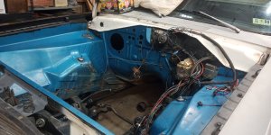

The black is coming off but the blue and scratches and rusty spots aren't a lot better
The firewall's going to be a bear. I'll have to take a lot of stuff off to get that mess straightened up to good enough.

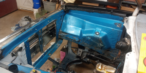

You can see a few places where I rubbed through but it seemed like it was thin there to begin with. Or something. No matter it's less ugly now. I will need a can of B5, hopefully there's a local paint supplier that can mix and put it in a spray can. I'm not going to go crazy sanding priming and all that. It will be fine.
The firewall is going to be nothing short of a PITA though. It seems like it might have been sprayed with different paint than the aprons and yoke.
A lot of the sloppy stuff right under the fender was me, gobbing rustoleum on that flange. I'll do a little better on that before I stop, if not the spray bomb will hide it. The top of the apron on the other side was sanded and primed with hot rod red before I got it. The primer there was me ugly fixing some rust that is never going to be seen again. I ground it back to rust-free, and welded a patch over the hole and then welded the edges to the patch. The battery and the headlight bucket hides it. Good enough.

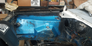

the amount of work it takes to get one small area clean
Cleaning the black off is easy. Cleaning the black off without wiping the blue off too is not so easy :)
There are places I can't get to, like in the pinch welds between the different panels. That kind of just looks like a shadow :)
