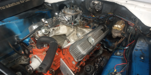

As far as pulling the engine, I guess I'll just bolt a lift plate to the intake, hook on, take out the slack, and unbolt it from the ears at the water pump ,then unbolt the ears from the chassis.
I'd rather unbolt the ears from the chassis and lift them out as one piece, but they're wider than the metal work above them so that won't work.

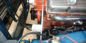

My nephew came over and got all worried about the elephant ears if I let the motor hang on them without the transmission. I don't think they're going to break but they look like they're already bent from someone doing that. I've got about an inch between the pan and center link so I'm hoping a piece of wood jammed in there will hold it up.
You can see it in this photo if you line it up with the oil filter and oil pump.
I'm still not sure what end of those things needs to be unbolted to get the engine out safely and without starting over.
The block of wood seems as good an idea as any. Your other option would be a bottle jack or jack stand under the pan with a piece of wood there.
If anything, that ear looks to me like it's bent forward, as if someone tried to lift the back of the engine with the ears bolted solid.

My solution would probably be to get the weight of the engine on the hoist, then break out the reciprocating saw or angle grinder w/cutoff wheel.
If for some reason you want to save them, once the crane is holding the engine's weight I'd think it's be easiest to free them from the frame side and lift 'em out with the engine. If that proves not to be the case, you've only got six more bolts to remove the water pump/housing assembly. There's no reason or need to pull the pump from the houing.
The more I look at it, the more I'm convinced I can just unbolt those two bolts from the frame and jog it around a little to get it above the frame rail on the side that's not notched.
