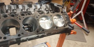

I had an old ring compressor last used about 1990 that was just too rusty to even start with, so I bought a new one at Harbor Freight. I didn't think of a set of ring pliers or I might've grabbed a set if they were cheap enough.

Checking ring gaps is tedious. I've checked 16 compression rings, and I've got 16 oil rings to go.
I want to think any mistake would've been on the part of the machinist, so if the compression rings check out, they all will. But as soon as I assume that, there will be a defective ring.

PS all 8 are in now.
