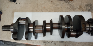

I stuck the crank and bearings in and plastigaged it. The funny part is I checked them using the metric side of the paper because I was using a tiny bit of the package that just had the checking info on it. Then I looked at the clearance in the book and it had me for a second until I figured out what I did. It's got between .0015 and .002 on all mains so it's OK.
The machinist mentioned those two balance holes on the right. They are kind of weird I guess.
I haven't compared photos to figure out if he drilled on it any but I think he did.

The balancing holes are not unusual a'tall. Those are most likely factory; I have several OE cranks drilled in a similar fashion in various spots.
